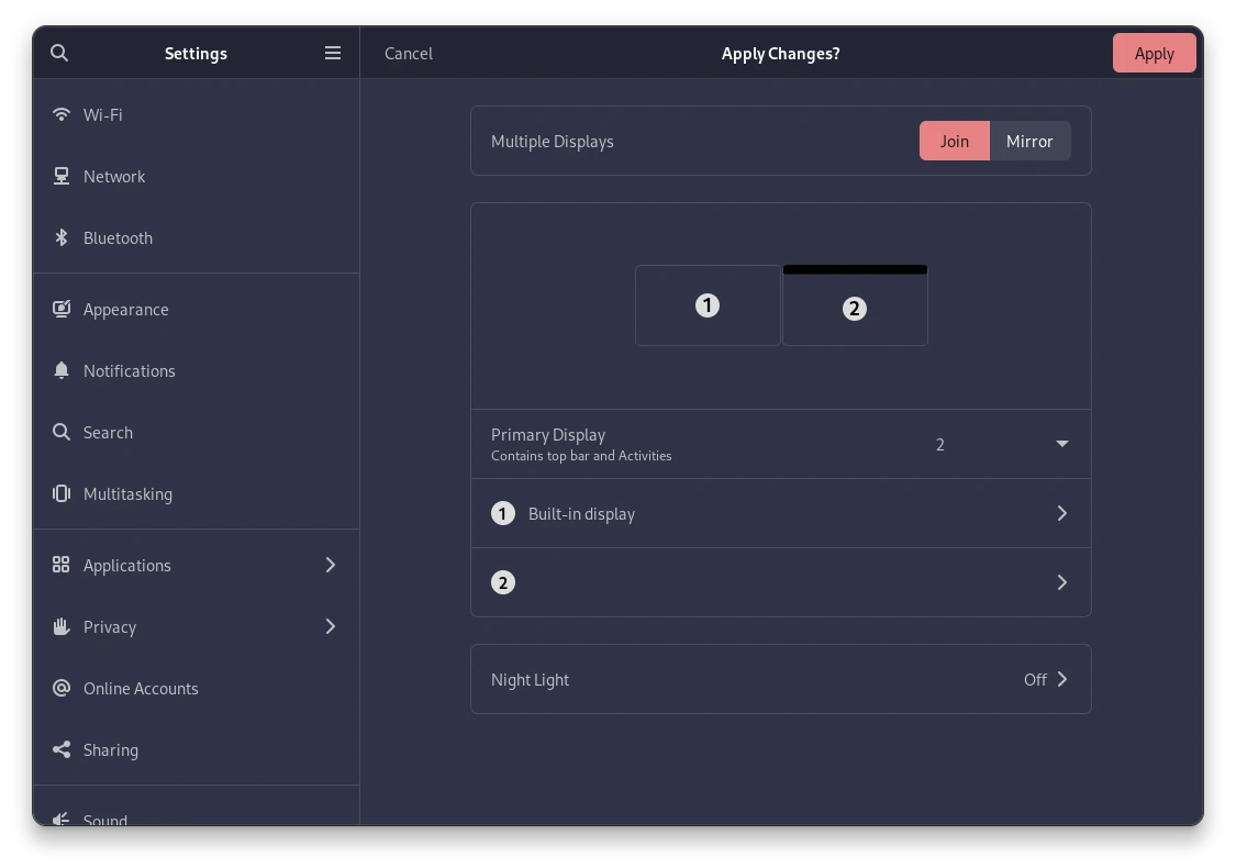

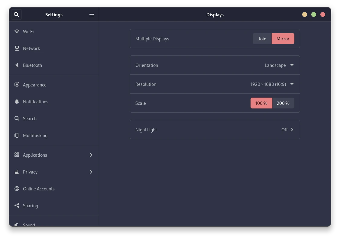

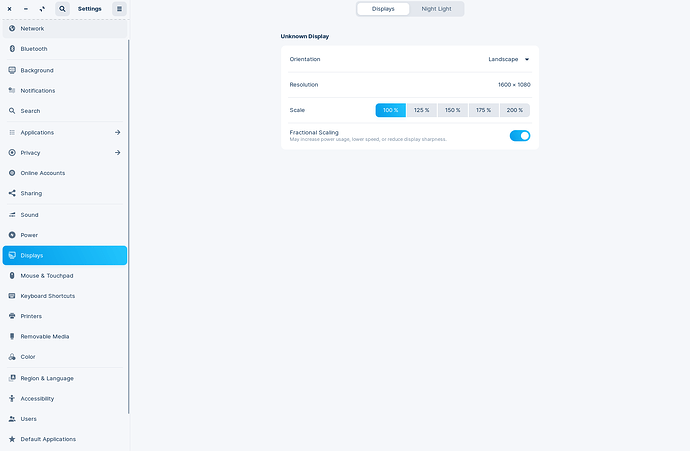

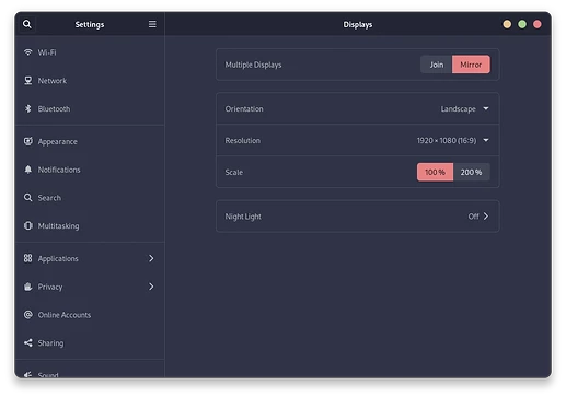

It doesn't matter if the 2nd screen is connected or not, the settings look the same. What might be the issue? I am connecting the screen via HDMI. USB-C didn't work.
Gday @garfunkel
If the 2nd screen is not appearing in setting/display "As per your photo"
This indicates that the machine is not detecting the 2nd screen.
First with the 2nd screen connected please run the "software Updater" shut down the pc,restart & test.
If you still have no 2nd screen in display settings.
Please show us the output of the following

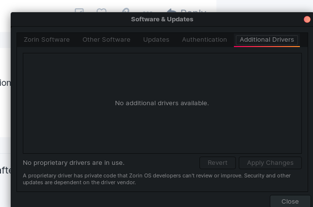

I would also check in updates -> additional drivers as you might need an additional propriety driver to use the hdmi - common with intel igpu and nvidia carded laptops ,

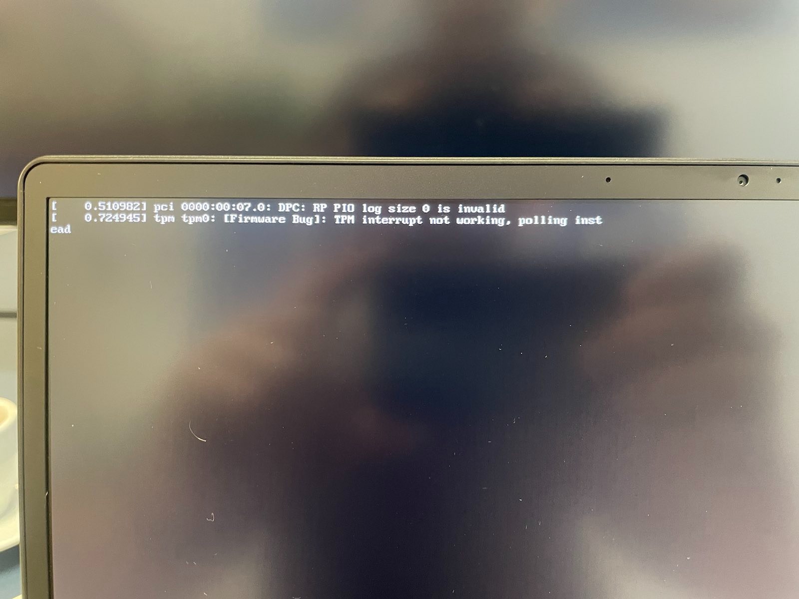

(Interestingly, the errors you showed in your photo are generally totally harmless. Something else with that kernel must have caused a problem that did not generate an error at that point).
