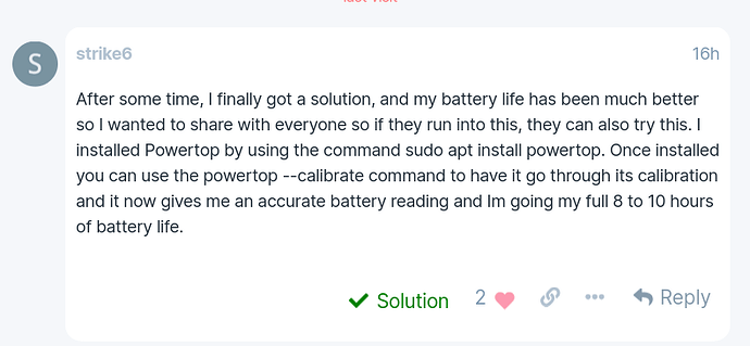

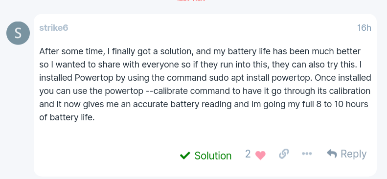

@centurion - I've just seen this and it could help you@
Unfortunately, neither version seems to work on my system.
TLP did not even start and Powertop displays the following messages :
“Failed to connect to generic netlink”...
Ugh, sorry :frowning:
