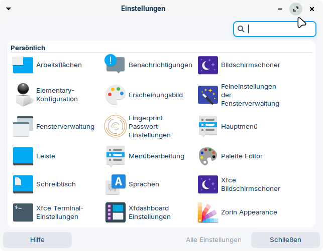

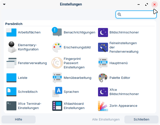

After many unsuccessful attempts yesterday, I finally managed, with kolourpoint, to insert the button screenshots into the Zenith theme. They prelighted buttons look good now. I also made a arrow button for the menu on the left side and changed the line "show app icon" in the themerc file to false.

I have a problem with creating the menu button, e.g. menu-prelight.png.
Is there a reason why in zenith dark theme this button is only 23x24 pixels, while the other buttons in the top bar have a hight of 36 pixels? In the Zorin theme it is 26x26.
Edit: I replaced your menu button with one of the other buttons which have the correct size, and now it works.
I have a hunch now: As you didn't use the arrow button in Zorin, but the app icon for the menu, you probably didn't want the app icon to be that big - it looks better at the size you set.

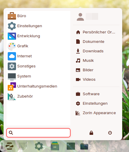

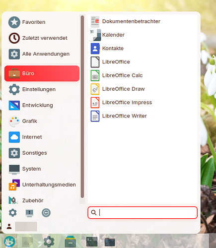

That's Whisker menu with good looking round corners:

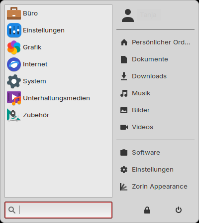

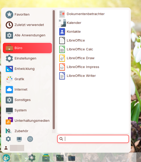

That's Zorin menu with frayed corners:
How can Zorin menu use the same corners as Whisker menu?

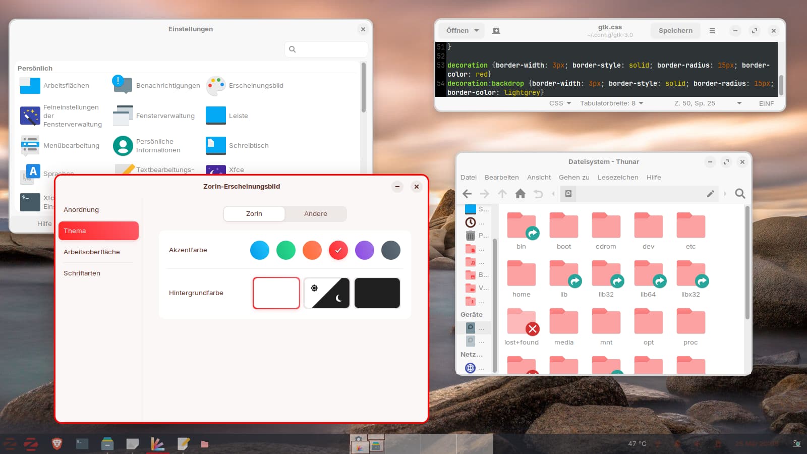

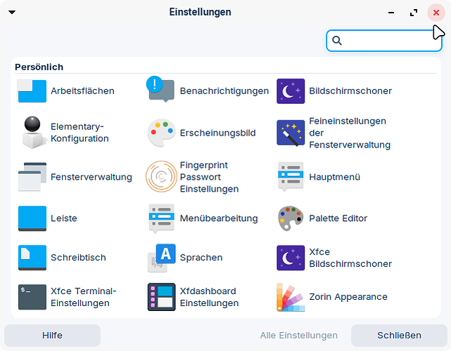

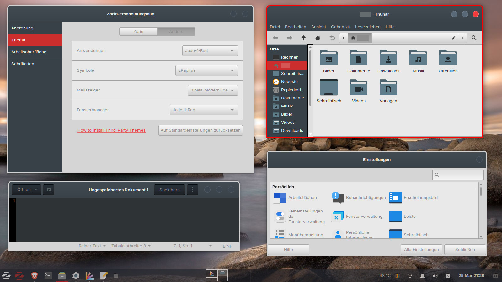

I tried another method to get colored borders in XFCE. This time I enabled CSD and used gtk 3.0 and gtk 4.0 .css file:
Unfortunately some apps look good, but for others (as e.g. Thunar or xfce4-terminal), the frame doesn´t fit at the bottom.
Zorin theme seems to be a bit difficult. With Jade-1 gtk theme and border radius just set for the top of the windows, I got a consistent look for many apps.

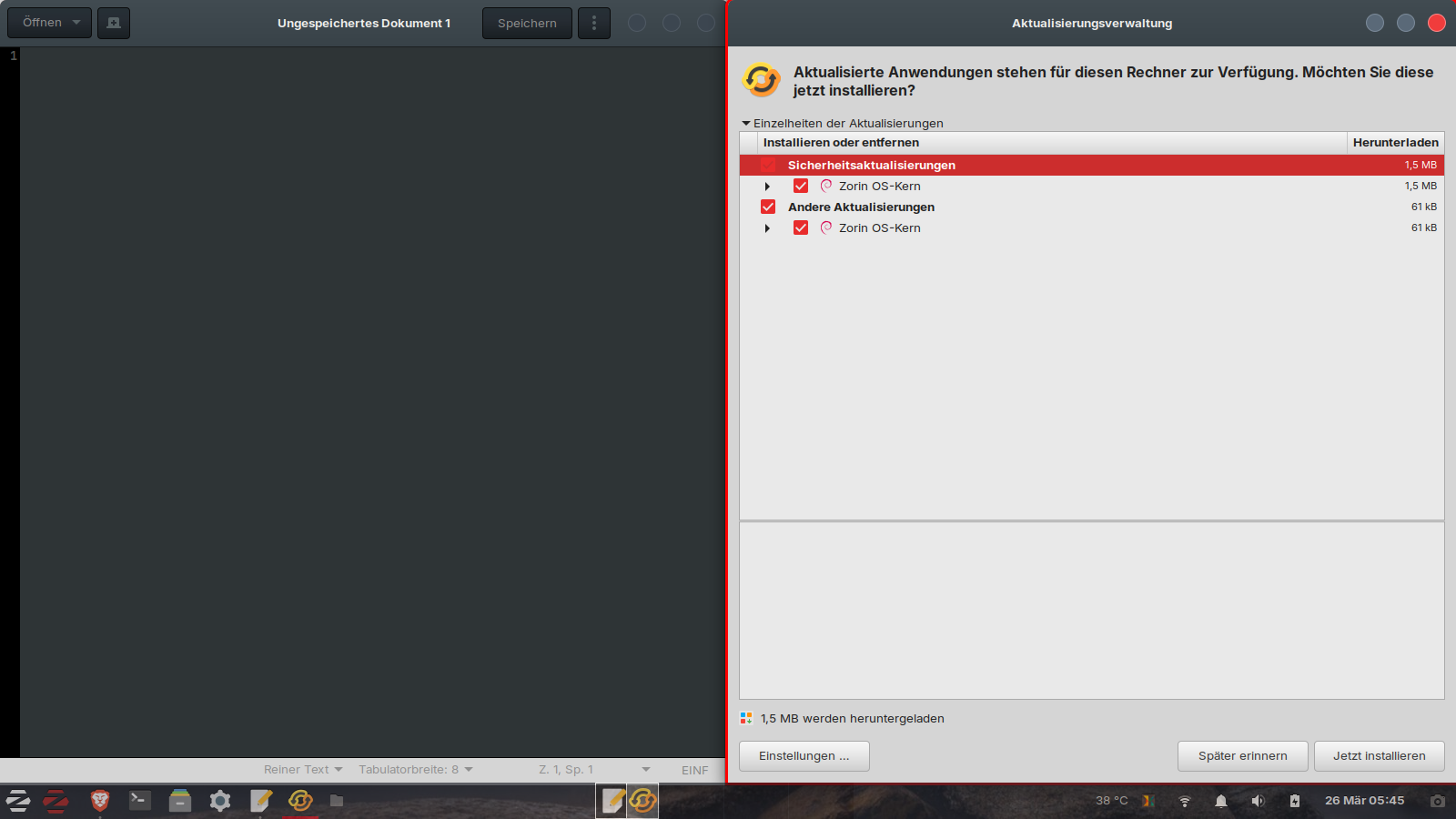

When the windows are moved to the edges of the screen, the colored borders are not visible. How can the colored frames be shown?
I didn´t find out how to avoid the black corners of Zorin menu with a custom theme and rounded corners (Zorin theme doesn´t have this problem). In Whisker menu I set the opacity to 99%, that helped so that Whisker menu has no such black corners. How can I set the opacity for Zorin menu? Or is there another solution?
In Window Manager Tweaks > Accessibility tab, Uncheck the option to "Hide window frame when Maximized"
First, in Window Manager Tweaks > Compositor, is "Enable Display Compositing" checked to On?
Yes, the display compositing is turned on and "Hide window frame when maximized" I turned off.
In my Zorin VM it doesn't help to show the colored frames. I'll try later on my other computer.

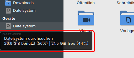

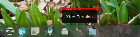

I made something wrong because the red frames are shown too often, e.g. when I hover the mouse over the launchers in the taskbar and the names of the apps are shown, or when I hover over the sidebar in Thunar. I'd like to set the decoration frame only for big windows. How can I do that?
It looks like it may be set as generic Window border, which may explain if it is not appearing too, for apps that use notebook stack.

In post 72 you can see a screenshot of the .css with the lines for the decoration.
I've tweaked it a bit since then so that only the top corners are rounded and changed the radius to 10px.
Post 72 has a link for Rounded Corners Gnome Extension, but no screenshots. I looked at the surrounding posts that do contain screenshots and see 74 contains a very small snippet...
