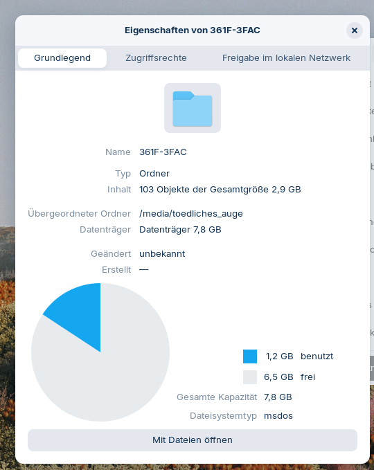

this is the usb stick:

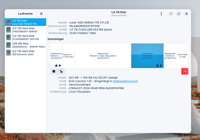

Yes, the permissions are changed for your Zorin OS build. What drive/partition is Zorin OS installed on?
Its on this partition (Lexar SSD(M.2) Partition 4)
