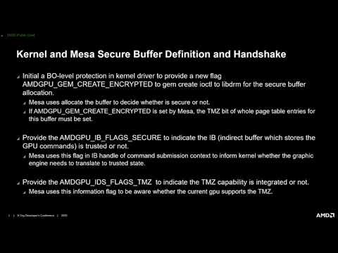

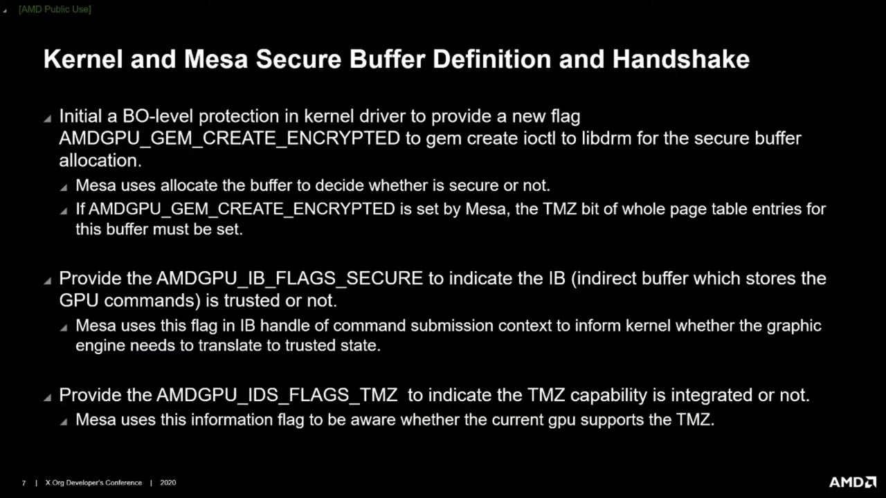

You'll notice the following that caught my attention:
vgaarb: deactivate vga console
Trusted Memory Zone (TMZ) feature not supported
Direct firmware load for amdgpu/tahiti_uvd.bin failed with error -2
amdgpu_uvd: Can't load firmware "amdgpu/tahiti_uvd.bin"
[drm:amdgpu_device_ip_init [amdgpu]] ERROR sw_init of IP block <uvd_v3_1> failed -2
amdgpu_device_ip_init failed
Fatal error during GPU init
robe of 0000:01:00.0 failed with error -2
Not sure if this pinpoints a problem that we can solve though..
