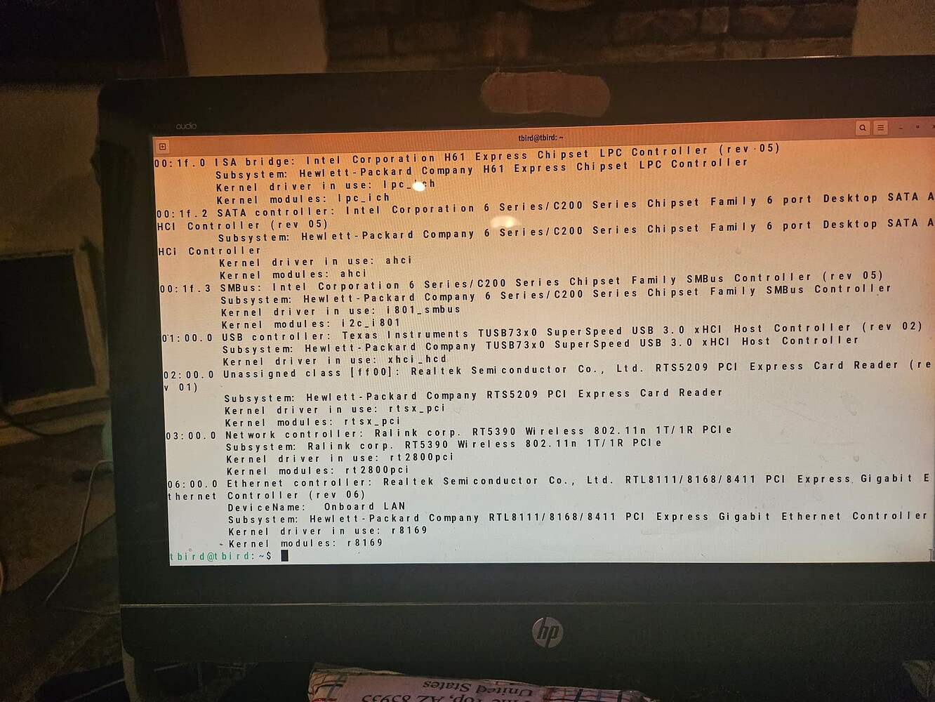

The photo below shows the network card i. the all-in-one. User has tried several power recycles to no avail:
He could try to reload the driver with
sudo modprobe -r r8169
sudo modprobe r8169
If that doesn't help he can reinstall it with
sudo apt remove r8168-dkms
sudo apt install r8168-dkms
If they can't connect to internet that isn't going to be possible. Not sure if they are able to tether. Will check.
It is a driver that is included in the kernel. So the best would be to boot into previous kernel before trying this solutions. For that no internet is needed.
Didn't You wrote above that there is no Wifi? But on the Picture I see a Wifi Module.
