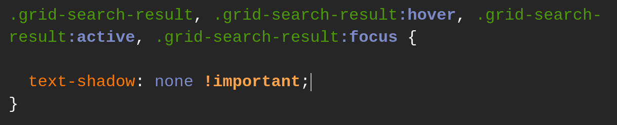

sometimes in some theme there is more than one .grid-search-result, try to see if you find more, and .grid-search-result:hover, .grid-search-result:active, .grid-search-result:focus, you can force everywhere you find this entries
I looked for these and found some. I changed but it didn't helped. then, I simply took these Values and added them as an own Block and add the text-shadow Value to it:
but this unfortunately didn't helped, too. I found these Valuse on other Places but there it was related to #dash and #dashtodockContainer where I thought that it isn't relate. Or is it?
If you add your block, do it at the end of your file , because of CSS cascade.
You can try for #dash and #dashtodockContainer maybe a key is behind that
Okay, I tried it with adding text-shadow: none toevery Entry what I could found (58 in total) and it didn't changed anything. Then I added the Block at the End of the css Fils and that didn't worked, too. But I'm thankful that at least the App Grid looks normal again.
try with this key
.list-search-result
Bingo! That helped! I searched in the css File for that and had 13 hits. I added that and now no Glow anymore. Thanks!
