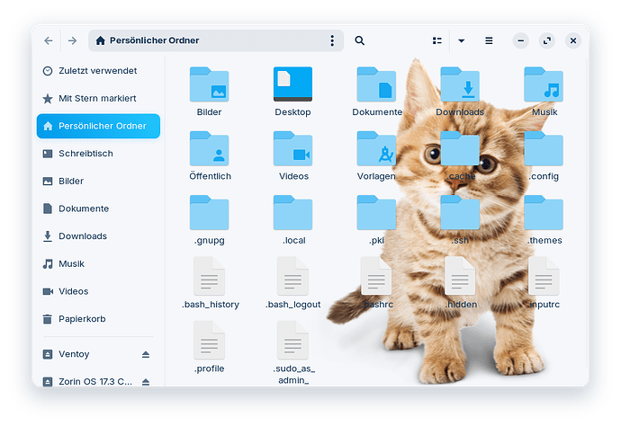

Background image for Thunar and other file managers
I wanted to test setting background images in file managers and added the Qogir background image to the Zorin theme.

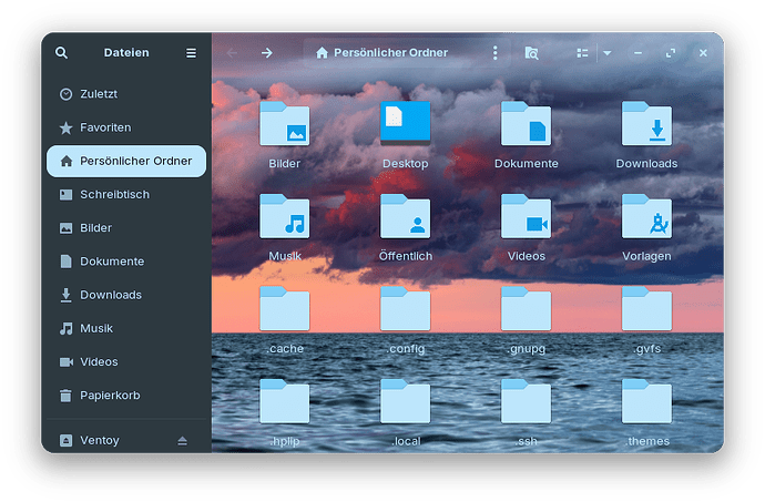

With the Qogir theme, Thunar displays the background image, but not with the Zorin theme. Nautilus and Nemo work with the Zorin theme.
What could be causing this?
Do I need to adjust the opacity somewhere or add a box/widget or something similar to Thunar?
Quitting Thunar didn't help.
Do I also need to add something for GTK2?
I made the test in Zorin 17 Core live session.
I added these lines to the Zorin theme .css gtk-3.0 and gtk 4.0
window.thunar notebook scrolledwindow.frame.standard-view, .nemo-window .nemo-window-pane notebook scrolledwindow.view,
.nautilus-window notebook > stack {
  background-image: -gtk-scaled(url("assets/backimage.png"), url("assets/backimage@2.png"));
  background-repeat: no-repeat;
  background-position: bottom right;
and put the image to the assets of gtk-3.0 and 4.0.

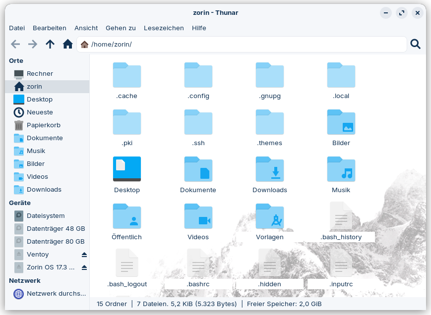

For example, I tried using wallpapers from /usr/share/backgrounds of Zorin as backimage (I set the default Zorin background image with the mountains to grayscale and made it lighter and less contrasty, but only a small section of the image was displayed in Nautilus, not the entire image). So it seems that the size or dimensions of the image are important.

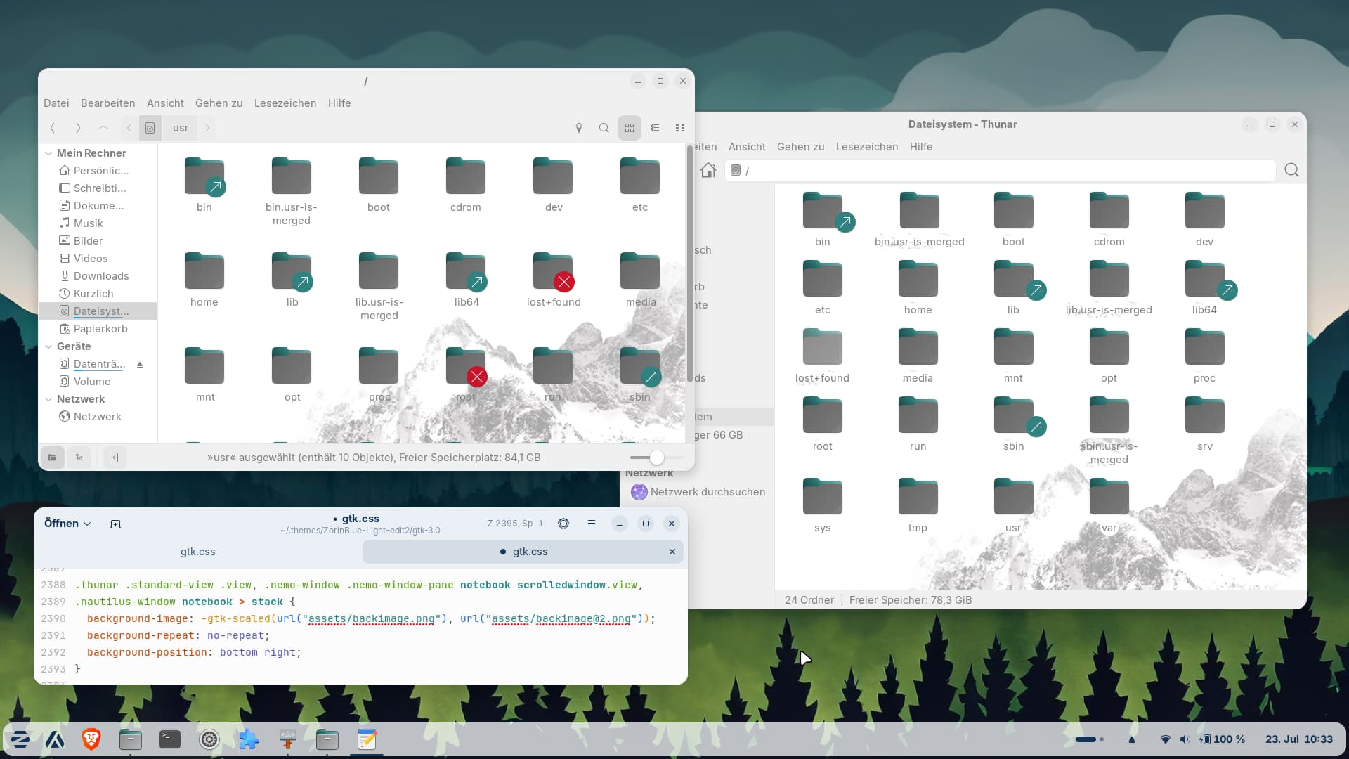

I tested it on my Zorin 18.1 Core system, and there it doesn't work with that command. I also tested window.thunar notebook scrolledwindow.view, but no success. It seems to be even more difficult in Zorin 18, because of this I started yesterday with Zorin 17.
In Zorin 18, with the Qogir theme (didn´t use the libadwaita option during installation, but added empty .libadwaita files and copied the gkt.css and assets folder to ~/.config/gkt-4.0) nautilus showed no background image, but nemo and thunar did.
With Zorin theme, only nemo showed it with the original added lines.

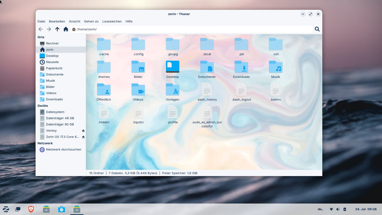

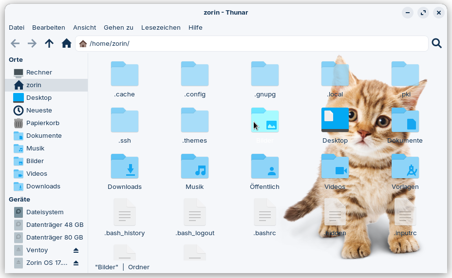

I found an old thread in xfce4 forum from 2020 and tried this line
.thunar .standard-view .view`,

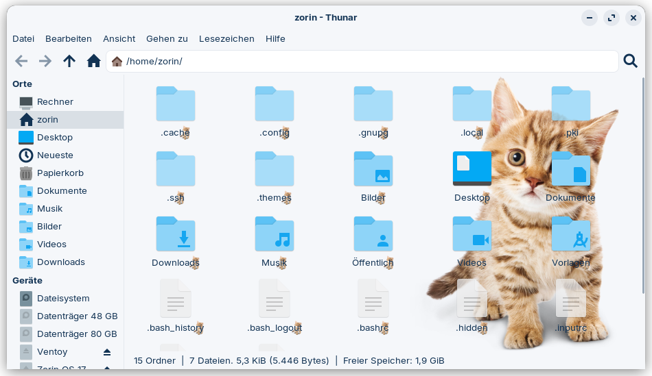

and first time thunar showed the background image in Zorin theme, but partially errors. The labels also have a background image. On the left side of the screenshot is nemo, on the right side thunar.

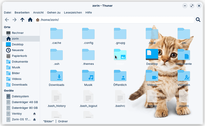

I found that old thread and tried it, but didn't work. Maybe I make something wrong. No background image with those commands in new gtk.css files at ~/.config. When I put the command .thunar .view into the Zorin Theme, many background images were also displayed on the left side of thunar. The bad look on the right side is because I had made the image background blue-tinted.

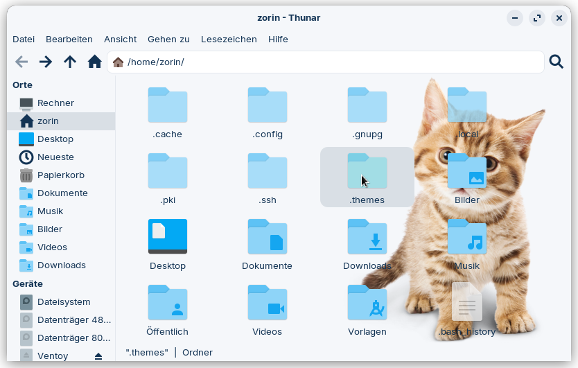

In Zorin 17,
seems to work without errors. The labels are readable, but don´t look very nice. I set the image with the white background now.
After so many hours of trial and error, finally a little progress.

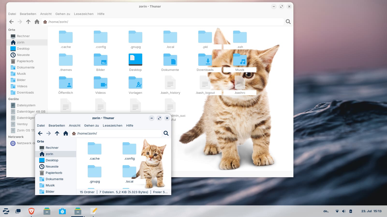

I tested it now with the cat again and set the lines
background-image: url("assets/backimage.png");
background-size: contain;
The cat is never cut off now in all window sizes. I don´t like the white long labels.
It would be nice if I could adjust it so that the cat doesn't take up the entire vertical space, but only 60% of it, like a invisible box in the right bottom of the thunar window which is e.g
60% of height and 30% of width.
Nautilus has transparent labels in the Zorin theme and non-translucent hidden folders/files. The look is much better there, but difficult to read.

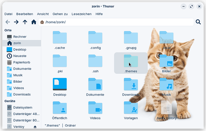

Do you know how to set the background color of the folder/file labels in Thunar to transparent? I've tried to find some information about this, but unfortunately I can't find anything on how to do it.
In Nemo and Nautilus, they're transparent (in Zorin theme of Zorin 17).
Do you have any idea what that setting/class might be called?

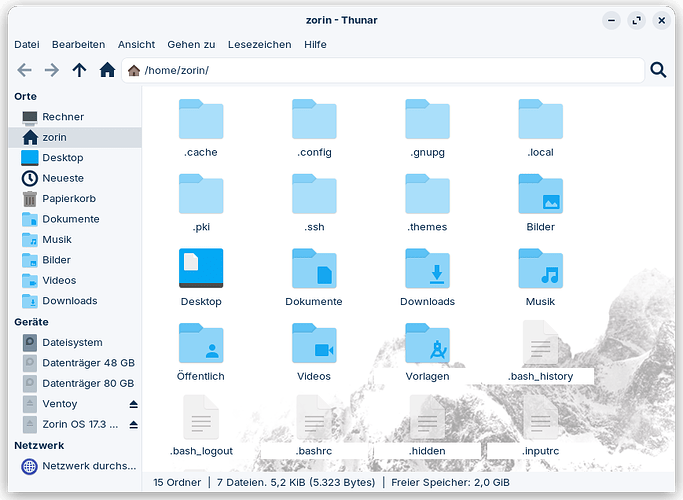

I added background-color: transparent; to the stack, and now the white labels are gone. I need to remove the background picture now from the labels.
Edit:
Now some success. Next step is to set another color for the selected folders/items, because they are in font-color white now and not readable.

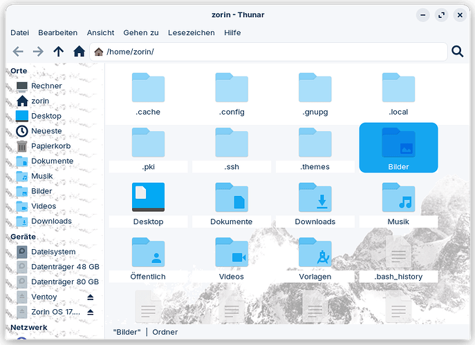

I find, thunar looks now better and more similar to nautilus with the blue right side.
So, now I have found a solution for the white text of the selected folders/files. I set the same color as in the sidebar:
.thunar .view:selected, .thunar iconview:selected { background-color: #d9dfe5; color: #123354; }
For now, I'm satisfied with Zorin 17. I hope there will not other layout errors appear.
For the white font-color in the labels I added
.thunar .standard-view .view { color: white; }
For the background images I set
background-size: cover;
this time.

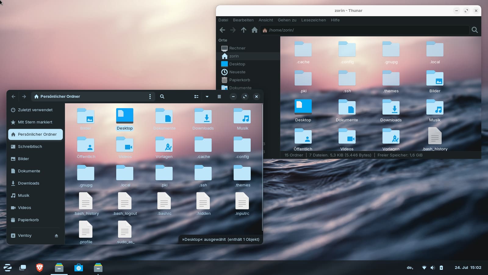

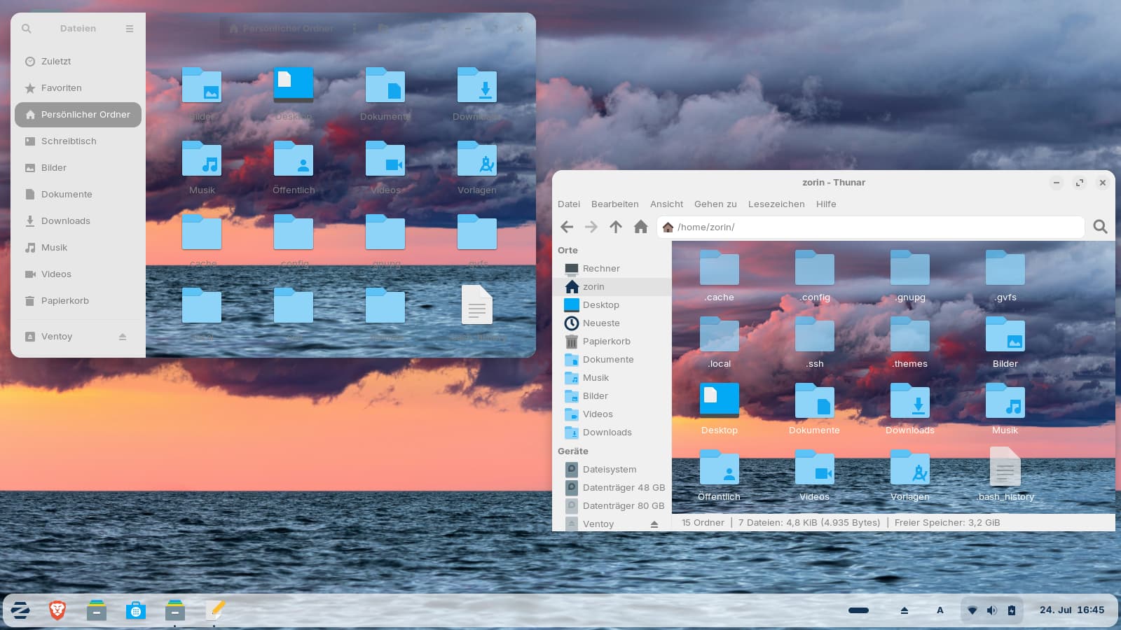

Thunar and Nautilus in Zorin's dark theme:

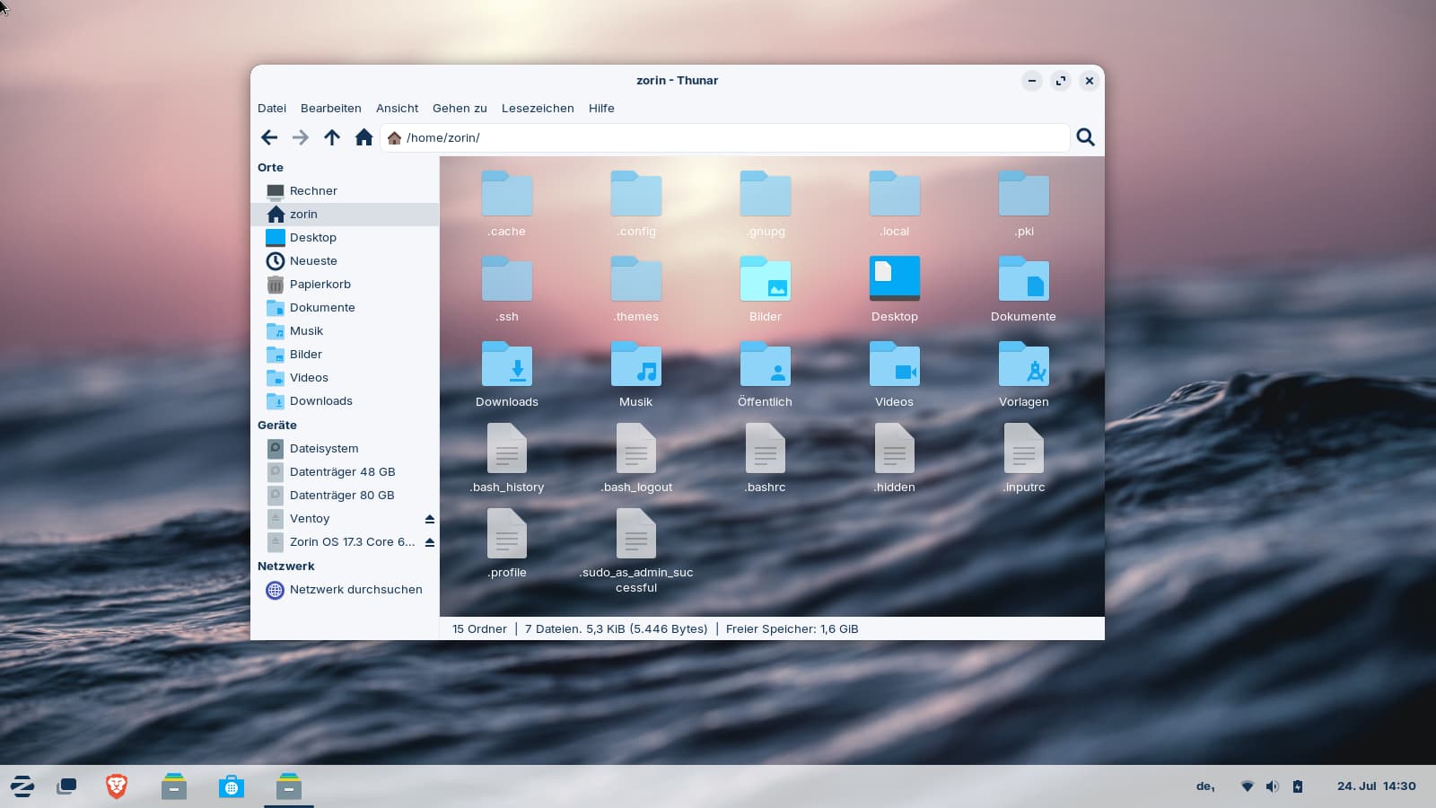

Now I tested it on Zorin 18 Core, but this time in a live session.
The settings of Zorin 17 worked for Thunar and Nemo, but not for Nautilus. Nautilus showed no background image.
I removed the notebook > stack and set just .nautilus-window, but now the headerbar of Nautilus also has a background image and a part of the image is under the sidebar. What could be the right class for the area with the folders/files?
It is not ready yet and the image not suitable as background, just a fast test. The font-color is not ready, I had to care for other things first.
Edit: With the dark Zorin theme, the headerbar of nautilus is readable and the window looks good. For light themes, light background images are the best, then you do not have to change the other fonts and label colors, and for dark themes, dark background images.
