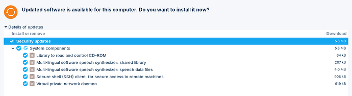

It was an extremely short time frame - 1 week as well - as well the OS was stable ... Where are the list of published rolled out updates (security and or otherwise) from Ubuntu - listed and grouped by date? Wouldn't mind verifying the updates I'm getting. Anyone know where I can verify Ubuntu has published these updates, like a list, not each individual one.
Example - say Friday a list of updates roll out - the list looks very similar to the one I see, except I see it on Ubuntu's website as a list.

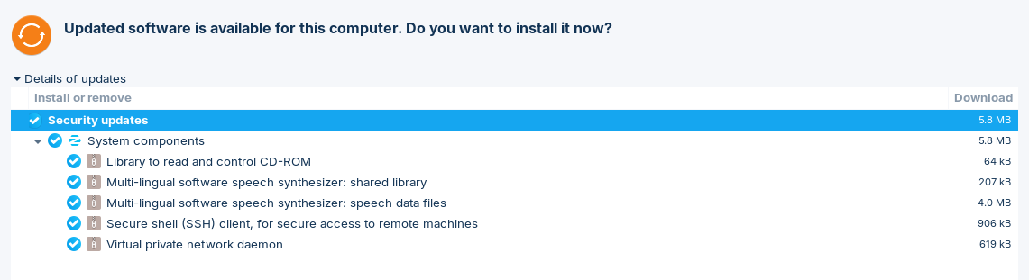

These are my current updates I have since the last time I posted:
Here is the listed group of Changelogs for Ubuntu, by date. You will need to drop through Main, Multiverse, restricted and Universe repositories: https://changelogs.ubuntu.com/changelogs/pool/
Finally, any user can use the terminal to review their upgrade history in the logs, which is useful if an upgraded package causes an issue that needs to be rolled back: grep "upgrade " /var/log/dpkg.log
In addition to reviewing logs and sites; a user should review any and all System Upgrader notifications. Click on the Details Of Updates > Technical Desxription for the listed packages that the updater wants to address.
I do this every time.
