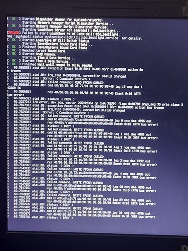

I did exactly as the tutorial said, I thought everything was ok. But a few hours later, I left the computer and when I came back, I could no longer enter my password, the lockscreen was frozen. I restarted the computer and an error appeared when entering Zorin:

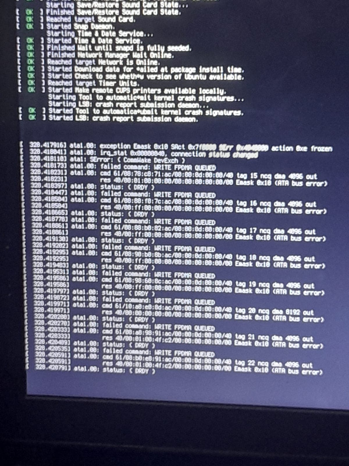

I tried to remove the swap, apparently I succeeded, but the error persists. Now however, when entering the system, the screen remains black for a while and soon after, the same errors appear.
How can I solve this?

I am a little concerned by the error. What the error suggests is that the drive itself is not responding to commands.
This usually can be caused by a loose cable. But drive failure can cause it. Off hand, I cannot think of anything that a swapfile might do that could cause the drive to stop responding to commands. I suppose it is possible; but if this was me, I would run a S.M.A.R.T. (test) on the drive.
You can check your terminal history file ~/.bash_history to double check what you entered in against the Digital Ocean guide to see if you had any typographical mistakes.

Ok, apparently I managed to recover. But I don't understand anything about what happened.
I entered safe mode, activated the internet and used the command:
sudo apt install --reinstall fonts-zorin-os-core zorin-desktop-session zorin-os-desktop
That I took from this thread: Unable to boot after removing libreoffice-gtk3
I have no idea why this worked. Apparently when I did all those customizations, something went wrong.
I'm just a little worried that I've broken something in the system from the tests I've done trying to fix the problem, but apparently everything is fine...
