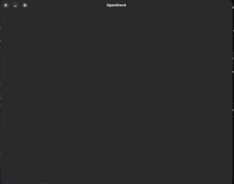

Black screen when opening some apps
I updated my system on Tuesday night, and when I went to use it again on Wednesday, I noticed that some applications had stopped working correctly; when I open them, the screen goes completely black or fails to display information, even though the data is actually there.
So far, I’ve noticed the issue with OpenDeck and Bruno API Client (which I need for work).
Could someone help me?

opendeck and bruno are both electron apps. after a tuesday update that black window with the data still "there" is usually the gpu compositor choking on them.
try this first:
  1. log out, pick Zorin on Xorg at the login gear, open those two again.
  2. if they work on Xorg, you are on a Wayland+electron bug. stay on Xorg or launch with:
    bruno --disable-gpu
    (same flag for opendeck if its binary takes it)
also paste:
glxinfo -B | head -15
and say nvidia / amd / intel.
I managed to fix the problem by removing the cached fonts.
rm -rf ~/.cache/fontconfig
fc-cache -r -v
