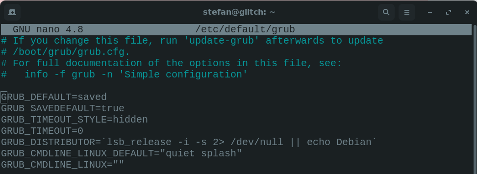

To set an older kernel to boot. See this should help: [HOW TO] set an older kernel to default boot
Forget what I wrote earlier. I successfully reverted to kernel 107. Thank you.
Did you remember to run
sudo update grub
as per: [HOW TO] set an older kernel to default boot - #9 by Aravisian
Uh... maybe. :grin: Not sure what I did wrong. Works now.
Sometimes you get a kernel that plays bad but the next one is good, so lets hope you can get a new kernel that works for you next time. (At least you now know how to roll-back and keep an old-but-good kernel),
