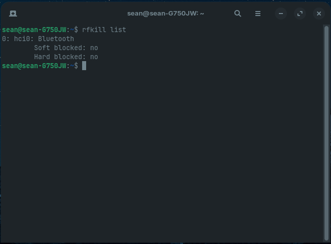

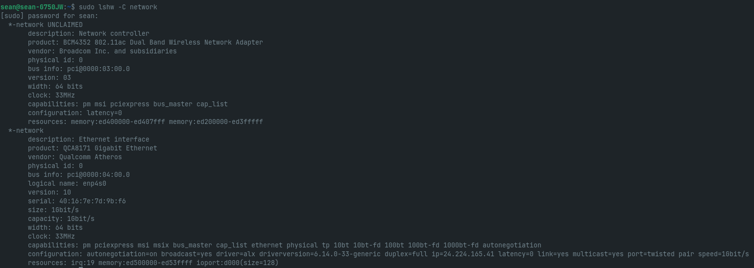

Here are the outputs from sudo lshw -C network and rfkill list.
Couldn't find any settings in BIOS that disabled USB ports.
I don't have another machine to test the adapter. All I can say is that any other USB 3.0 peripheral I plug in works.
Okay, that looks like from Your other Thread. So, it looks like the Stick isn't even detected.

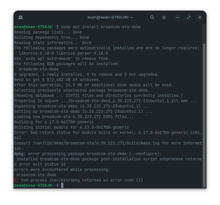

Since I updated to Kernel 6.17, I can no longer use my internal Broadcom wireless card. I tried purging broadcom-sta-dkms and then installing them but I now get an error.

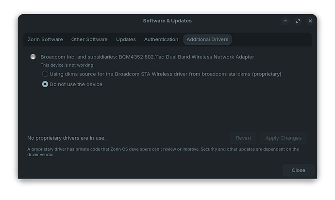

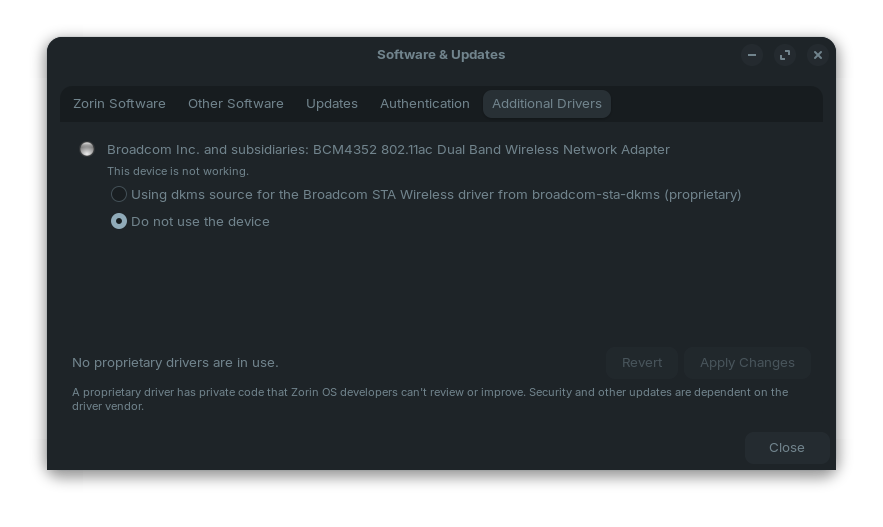

The card is listed under Additional Drivers but I cannot activate it.
I select the proprietary driver here and apply changes, however, it doesn't work, despite being selected after clicking apply changes.

DKMS is Dynamic Kernel Module Support - it allows that you can shift an installed module to a later kernel rather than performing a fresh install of the module if the kernel gets a system upgrade.
But the DKMS file must contain a reference to an existing kernel. Which is logical.
If a later kernel was released which did not exist at the time the DKMS file was created... that file has no reason to believe that kernel exists.
And 6.17 is so new, I bet a very large number of DKMS files do not know it now exists.
The maintainer has included 6.17 in this report
Installing from a repository will not always get that latest version - you may need to grab it directly.
