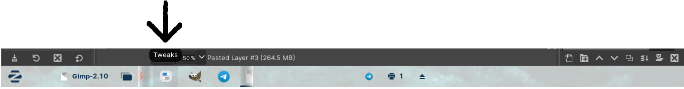

How i figured out how to return it to normal is i go to "Tweaks", see screenshot:

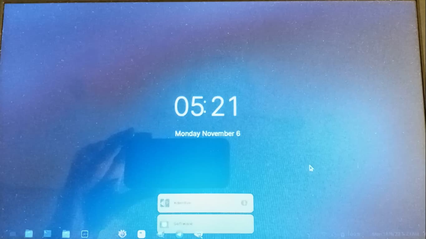

Then this happens for a split second, this "blue screen with the time", it was very hard to get a screenshot of this, in a millisecond the screen awakens and goes from black to this below, and then to the regular desktop & windows/programs:
Then in the screenshot below the blue screen with the time quickly goes up, in an upward motion and disappears and brings me to the desktop, you can see it moving up and then disappearing completely, which brings me to the normal desktop interface:
This is the exact time it always freezes, but it doesnt always happen, I'd say 30% of the time it freezes.

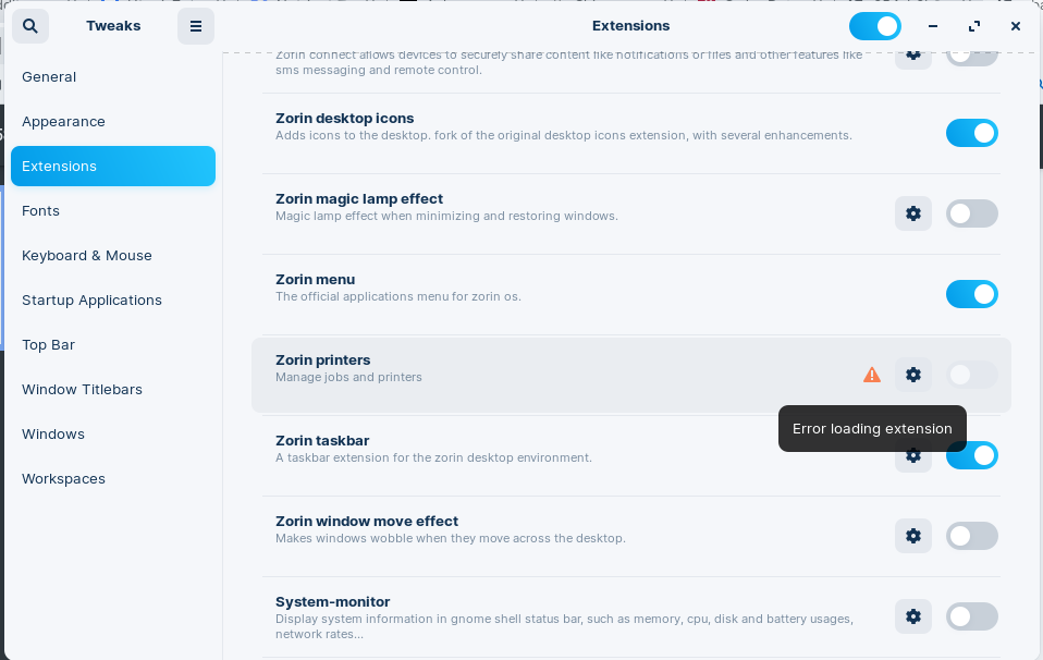

Something that i've for the 1st time just now noticed though is an error i never seen before with tweaks, which i've for a while suspected that "Tweaks" might be the cause of the glitching/malfunction:

That was not a terminal command; just a suggestion of another extension to check.
However, you have noted an error on the Zorin Taskbar, so let's look into that.
sudo journalctl /usr/bin/gnome-shell | grep 'zorin-taskbar'
