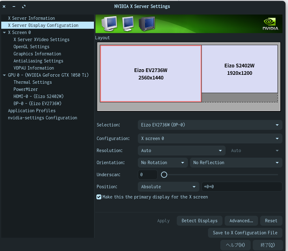

I just checked my NVidia settings panel.
I could decrease the resolution for both of my monitors:

Yes, if the OP has an Nvidia GPU, they should use Nvidia XServerSettings to change such values maybe, more successful then trying to use the OS Display manager.
