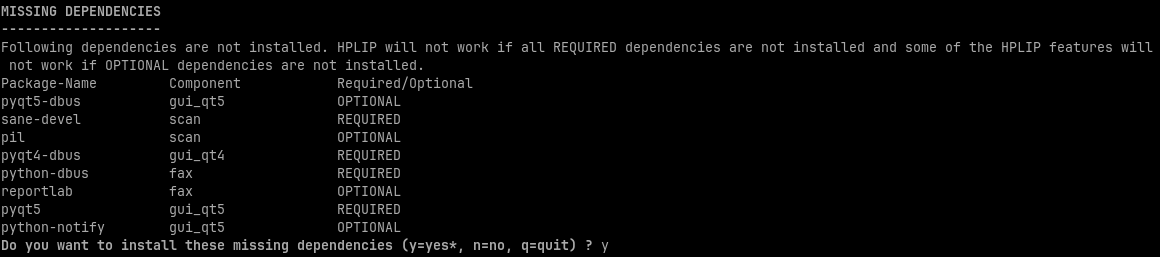

The python packages keep missing:
at all I will need all that packages and I installed about 5 but stuck with the Python ...

and hplip-3.20.5.run still stops with error: Installation cannot continue without this dependency. Please manually install this dependency and re-run this installer.

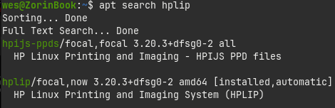

Going off your dependencies from the screenshots - most of them are not available, and I'm on Z16.3 Core.
I checked my install, and have hplip [installed, automatic] - do you have hplip installed already? Second one:
Screenshot from 2023-12-12 17-22-28
But, can't find those dependencies..

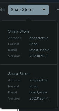

There are two hplip apps in the Software store as well:
They are Snap packages, so that may or may not impose an issue, but are more current than 3.20.

You could try the one in Software, for sure - they are listed as the same version, one is 'stable' branch, one is the 'latest / edge' branch; I would choose the stable one though.
The hplip package already installed can stay for now - don't see it causing any issues at the moment. It may or may not be removed with the newer install from Software (3.22.10-1).
them are both latest/stable latest/edge
wich on is the right choice. hplip-printer-app or ps-printer-app?

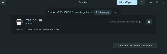

But that didnt make the system find the scanner. And I also can't use the printer allthough its installed:
But deleting and reinstalling the device made the Scanner apps find the device again :wink:
While both still can't read the device ...
