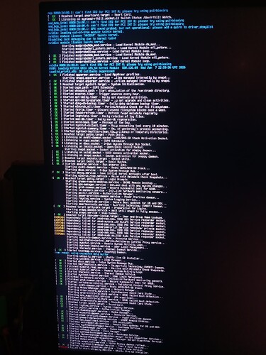

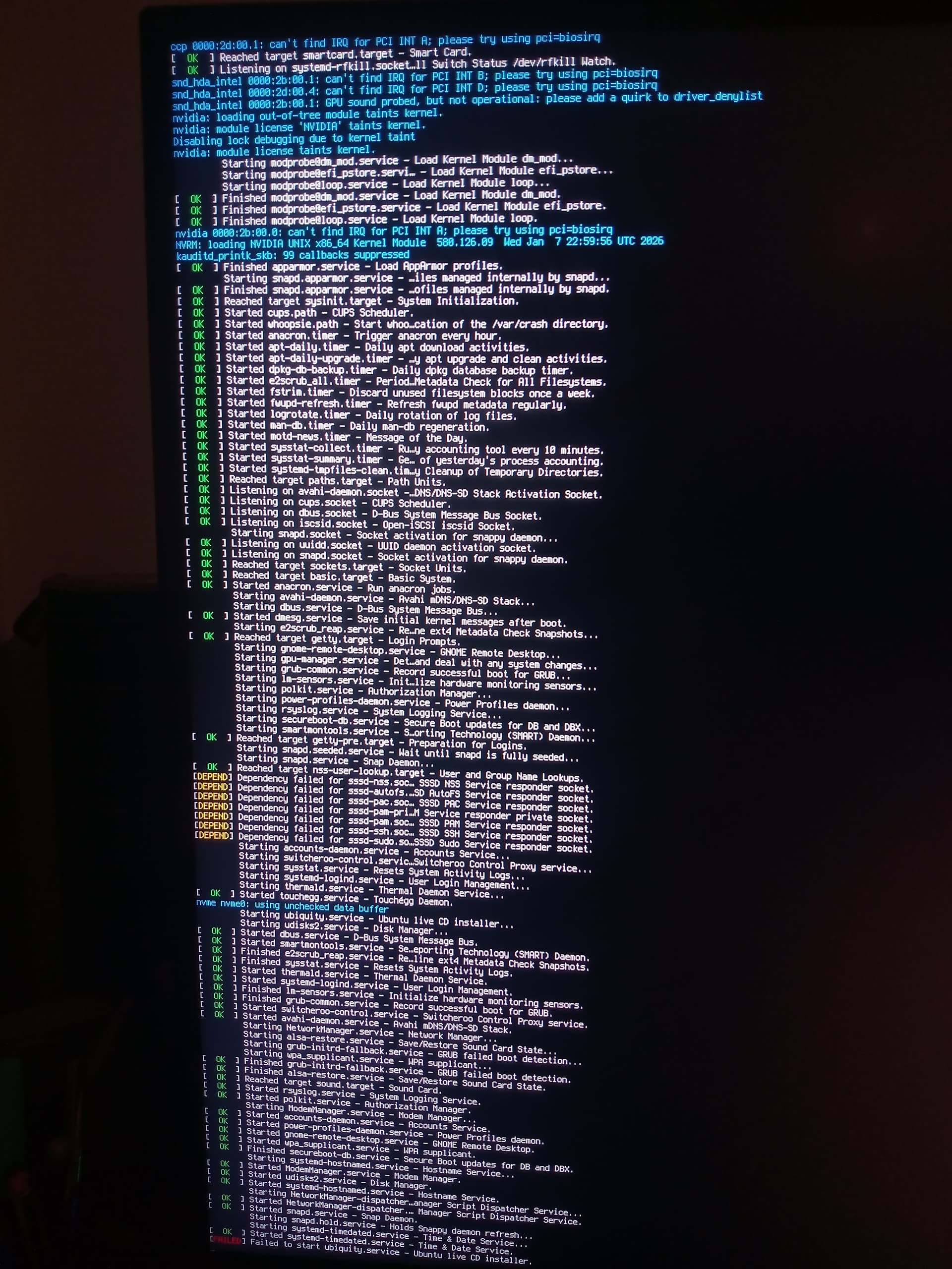

Ok! Progress. I did what you said nomodeset didn't Work, but ACPI=off did. I tried using the NVIDIA options but got these erro screen after loading the drivers

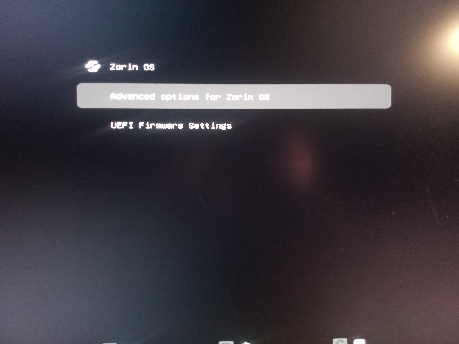

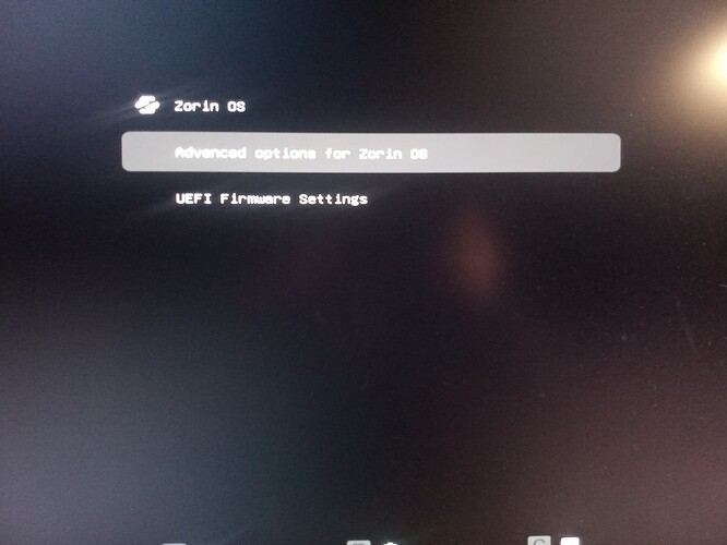

Now every time I boot my PC I get that black. However, when I press ESC when booting I get this GRUB screen
From that advanced options you see, click it
Then Drop to Root Prompt

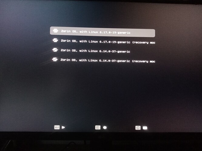

Just a quick question. I drop to Root prompt by pressing the E Key, right?
If so, do I press when selecting this first option?

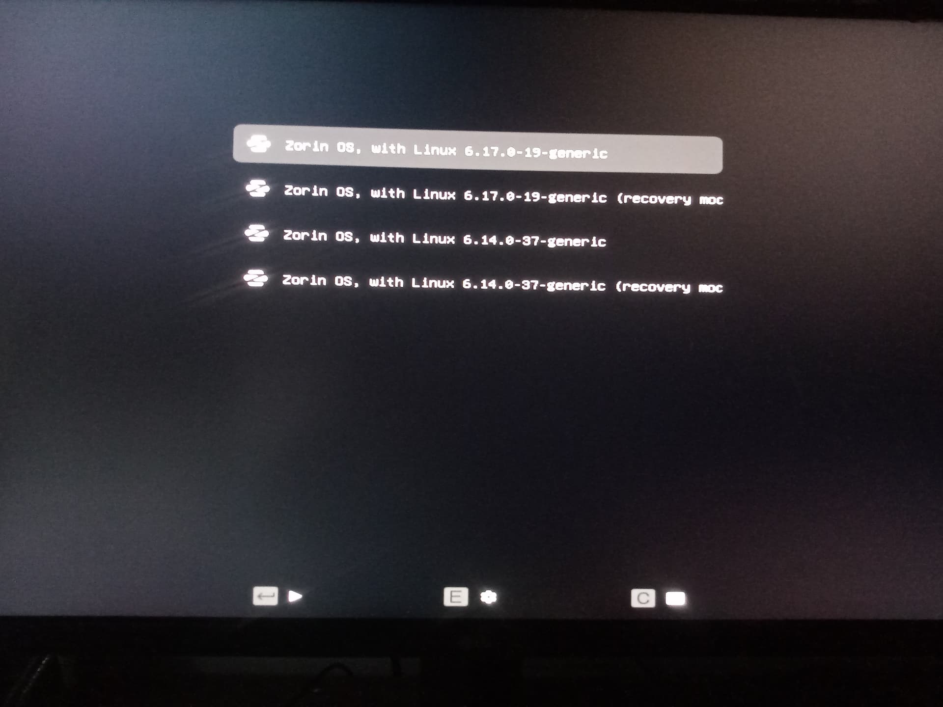

No, you select the second option shown in your screenshot (recovery)
This leads to the Recovery menu, at the bottom of which you will see the Root Prompt option.
When I select the recovery options I get another black screen... I waited I bit, but nothing happened
Try the forth (last) option...
