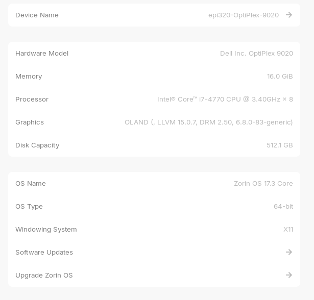

So this happens immediately after launching it? Are you running any other memory-intensive applications at the same time? Can you share your computer's specs?

Specs:

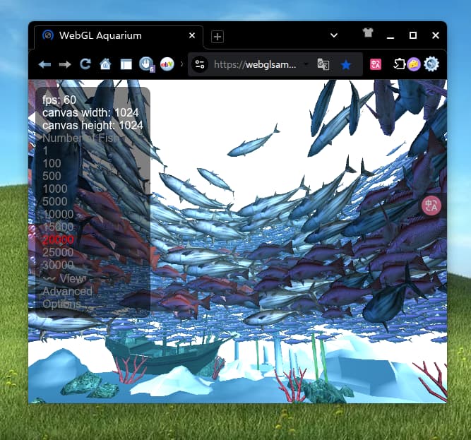

what interests me here that nobody seems to have asked, which GPU is this happening on and which drivers? it seems to be affecting some people but not all of us. I have no issues whatsoever using Google Chrome with hardware acceleration turned on (GTX960, X11 and proprietary nvidia 580 from the repos)
the other thing to mention, X11 or Wayland?
If I turn hardware acceleration on, my browsers become laggy. You would think offloading to the Nvidia GPU, would increase performance, as it did in the Windows 7 days! However, that is far from reality, so I have to keep HA off in all browsers. Thats just how it is on Linux.

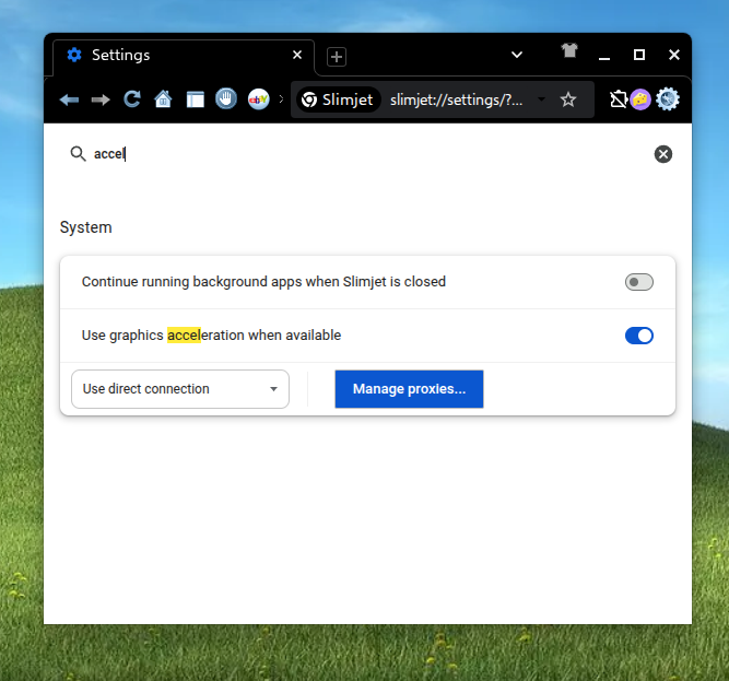

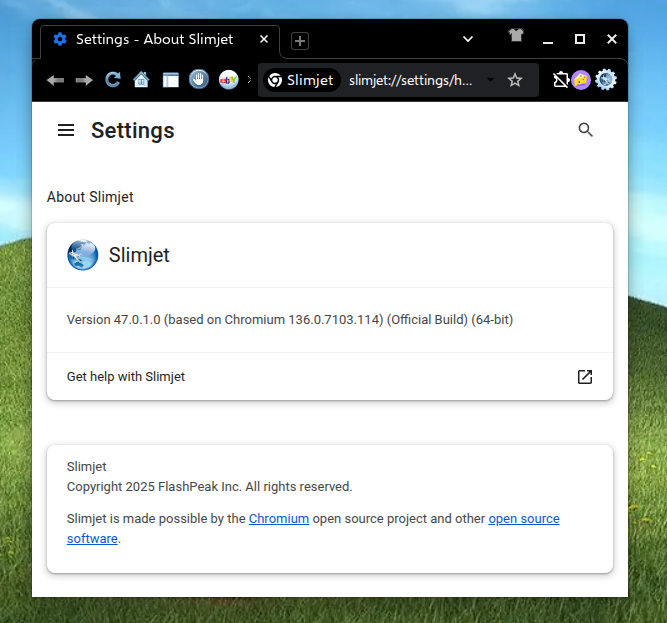

Slimjet on Integrated AMD Radeon Vega 8.
