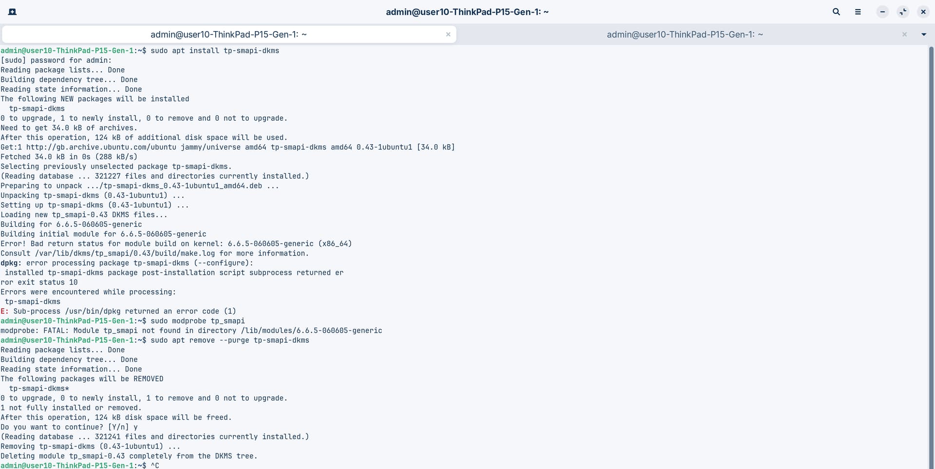

is it now advisable to do something about that openvpn issue? and do I need to reinstall / configure the Lenovo Thinkpad notebook package that we removed?
Not all Thinkpads are supported (By Lenovo), so let's do the steps - if it gives an error or failure, that means it is unsupported and you can just remove it again.
sudo apt install tp-smapi-dkms
sudo modprobe tp_smapi
To remove it:
sudo apt remove --purge tp-smapi-dkms
This one looks like a configuration within the repository file itself. OpenVPN is included in the Zorin Repositories, so you likely do not need to add the OpenVPN repo...
You can remove the OpenVPN repository using Software & Updates
Then run
sudo apt update
apt search openvpn
If the apt search showed openvpn listed along with like-packages, then you do not need to add the repository.

I see that tp-smapi failed and you removed it.
It shows OpenVPN packages but it still also shows that you have an OpenVPN repository added.
