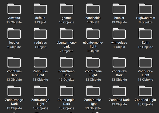

Another Thing what You could look for: go to /usr/share/icons and look if You find it looks like this:

The icon folders do look like your image. Here are the properties of the icon folder:
