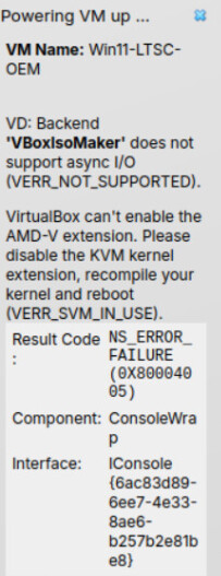

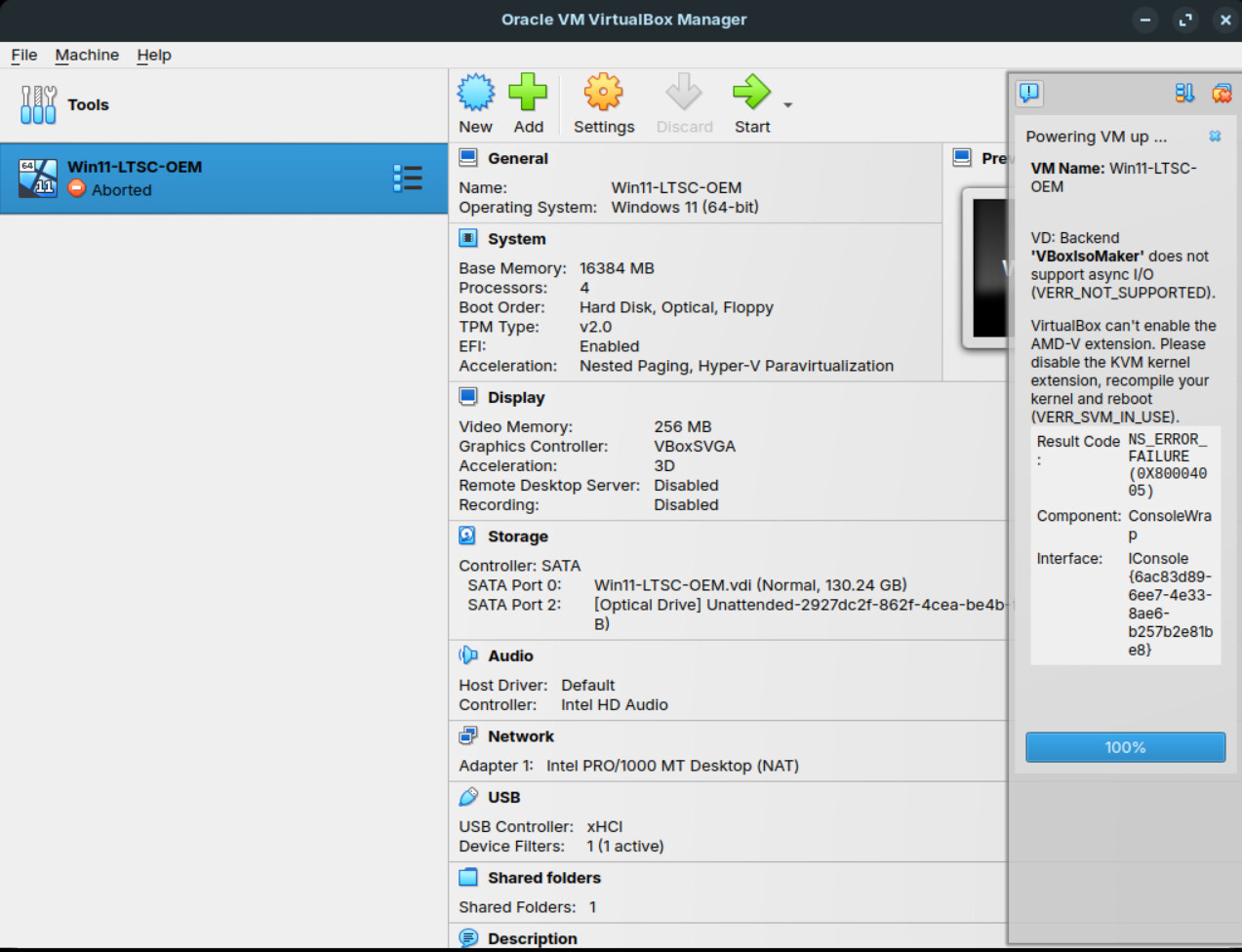

BUT WHEN I TRY AND START WINDOWS 11 IN VIRTUALBOX I AM GETTING AN ERROR - SEE PIC BELOW:

I tried still got the error when trying to launch Win 11 using Virtualbox
Looking at your posted error...
VERR_SVM_IN_USE
In the other thread, it is VERR_NOT_AVAILABLE.
It looks like KVM is in use, so VB cannot use it. Can you try (since you are using AMD):

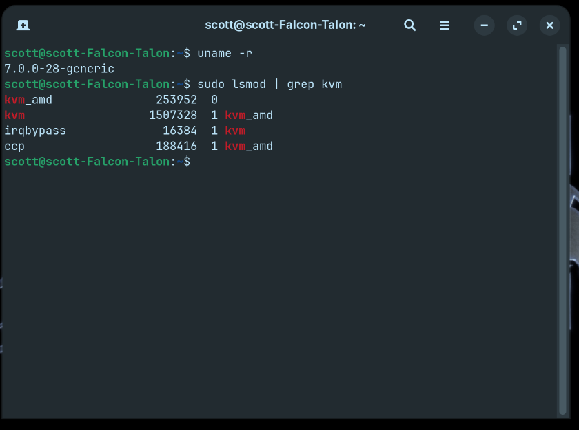

scott@scott-Falcon-Talon:~$ sudo lsmod | grep kvm
[sudo] password for scott:
kvm_amd 253952 1
kvm 1507328 3 kvm_amd
irqbypass 16384 1 kvm
ccp 188416 1 kvm_amd
Eh... That only shows what we know - that 1 process is using it.

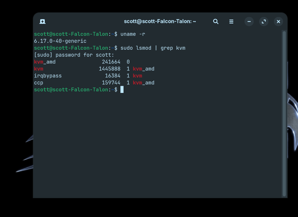

For grins I did a Time-shift back to 6.17.0-40-generic and have Oracle Virtualbox running Win 11
See screeny below:
Now not running Virtualbox:
From this, I do not know about you but, it looks to me like there is still an issue with the 7.0 kernel and the stable VirtualBox package in the repository.

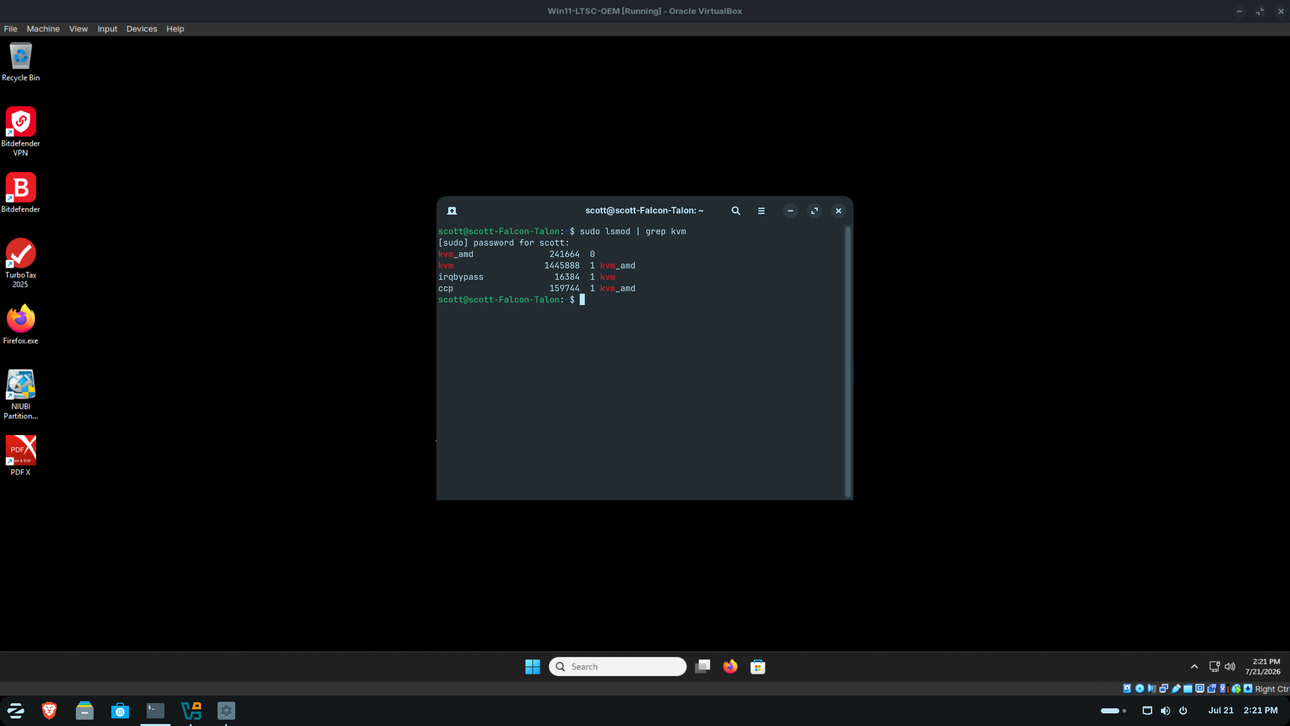

Yeah, I just re-installed kernel update 7.0 and here is the results from sudo lsmod | grep kvm:
