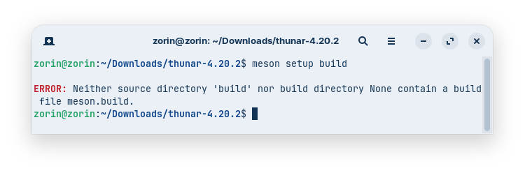

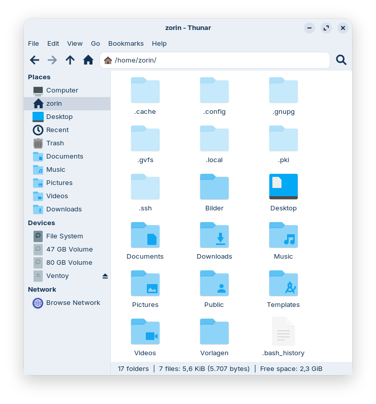

I try to compile thunar from source to adapt the color of hidden files/folders in Zorin 18 core live session.
In dark themes the default value for the translucency is good, but in light themes it is difficult to distinguish hidden folders/files. They have nearly the same color as normal folders.

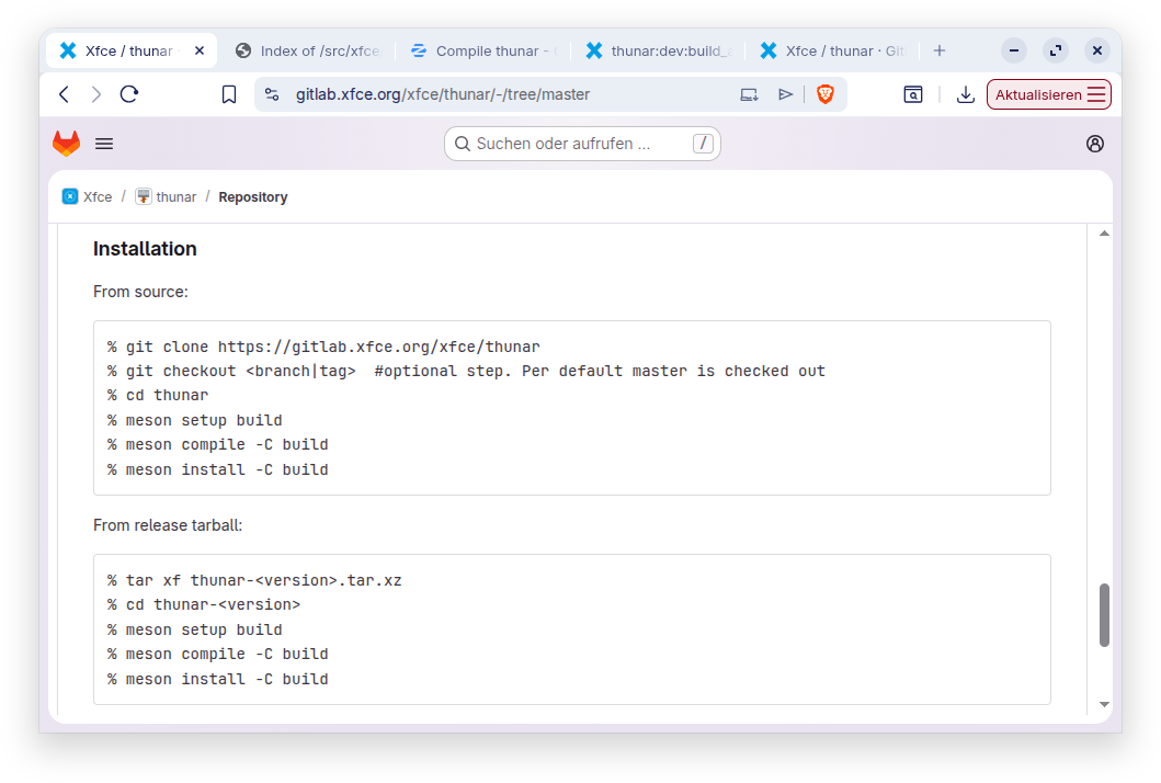

I downloaded the tar.bz2 file of thunar 4.20.2 from here und unziped it
But when I open the terminal there and enter 'meson setup build' I get an error message:
What are the *dev packages which I need? How can I install them?
The guide on the xfce website says this is the installation method, but I tested it with all tar.bz2 files of the 4.20 version of thunar and no one contains a meson.build file, only the 4.21 version has such a file.
Will it work when I copy the meson.build file from 4.21.0 into my thunar folder? Probably not, because there are listed all dependencies and 4.21 has other ones than 4.20.
I think the latest switched to Meson.
Prior to that, use ./configure, make, sudo make install

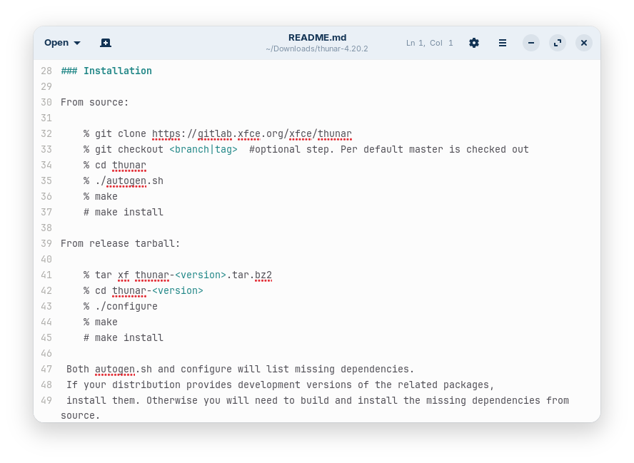

Edit: I now found the correct installation instructions for Thunar 4.20 in the downloaded README file

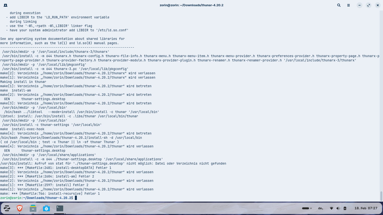

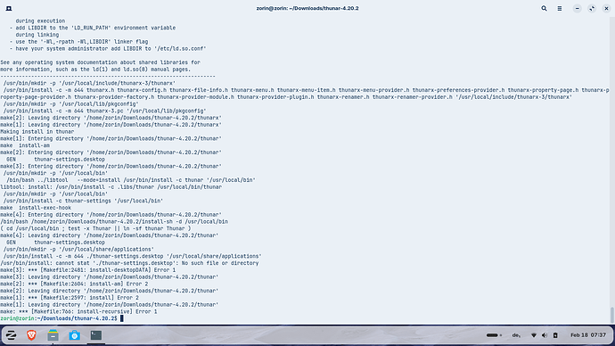

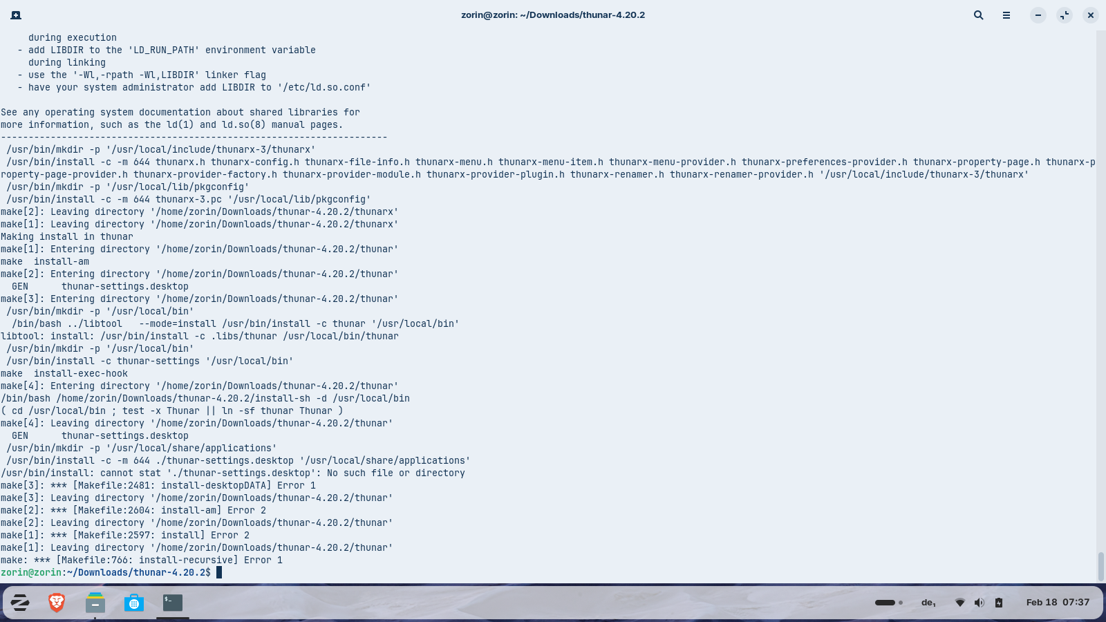

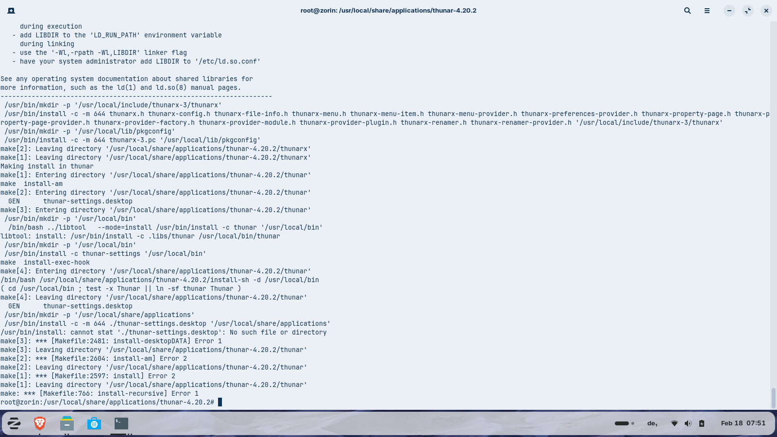

I'm not sure if I have understood you correctly. I put the downloaded thunar folder into /usr/local/share/applications and then repeated the commands. I also get an error:
What do you see on that line?

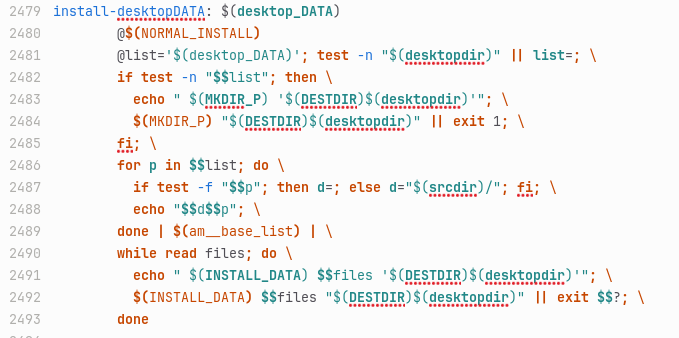

sudo nano +2811 Makefile
By the way, you should run the commands from terminal as root - without moving files or terminal into that working directory.
The commands should follow the install paths - it is not relative.

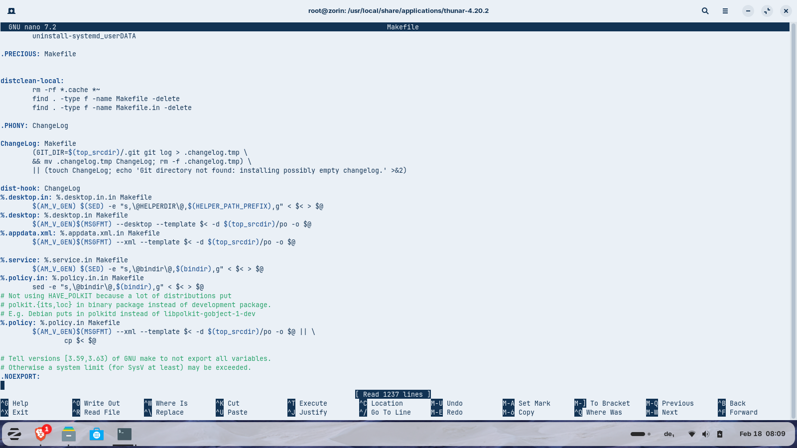

When I enter this command in a new terminal Window there is nothing.
The Makefile has only 1237 lines.
Ugh... maybe try your text editor...
What I am seeing is
/bin/bash: line 4: cd: /usr/local/share/applications/thunar-settings.desktop: No such file or directory
make[4]: *** [Makefile:2811: install-data-local] Error 1
Which looks like it is trying to cd (Change Directory) into a File instead of the directory.
It should be something like:
cd: /usr/local/share/applications/ && with the portion after the && generating the thunar-settings.desktop file. If you can check that line in the makefile (It shows 2811 as the line...) maybe you can see where the disconnect is.

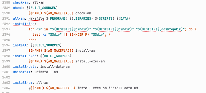

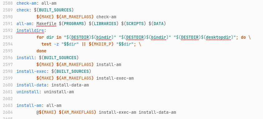

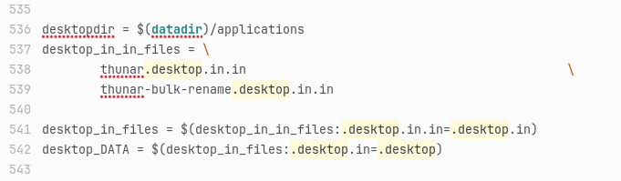

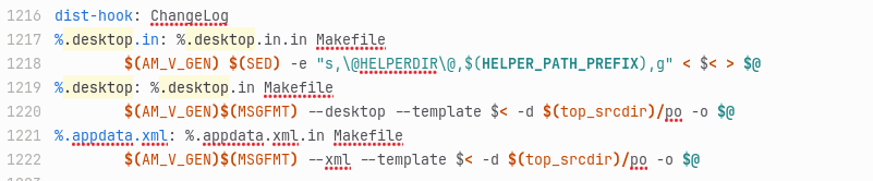

Now I entered the command from my opened terminal window at /usr/local/share/applications/thunar-4.20.2
and see this:

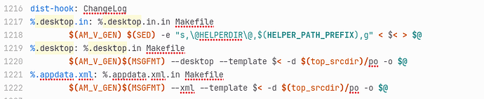

It is the whole Makefile file but it has only 1237 lines. When I search for 'install-data-local' there is nothing found. I searched for .desktop in the Makefile and found these (only some of the search results):

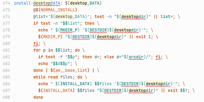

Ah, now I found another Makefile at
/usr/local/share/applications/thunar-4.20.2/thunar
which has more lines. Do you mean this one?

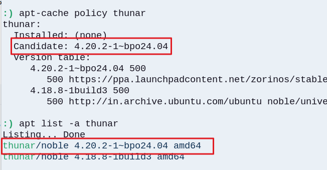

It seems to be thunar 4.20.2 is already available natively:
Just install it using apt.

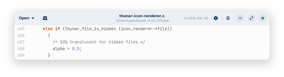

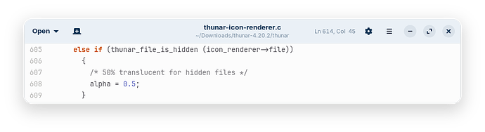

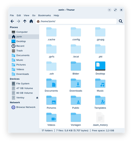

I think the hidden folders have a lighter color now with 0.5 translucency instead of 0.75.
It was a very laborious process for days - but it works now!

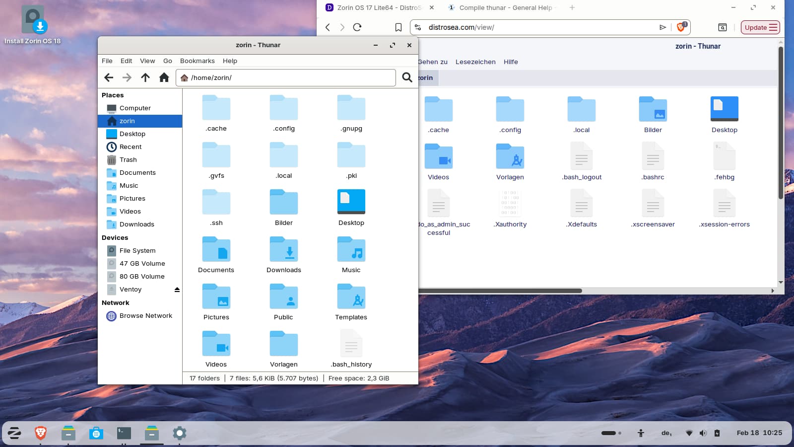

Here you can see the difference (I started Zorin 17 lite in distrosea, it has no the same thunar version but probably the same translucency value for hidden files to compare both and turned on high contrast so that the inactive window isn´t darkened):
That was the file which I edited before compiling. The original value there was 75% translucent and alpha = 0.75
