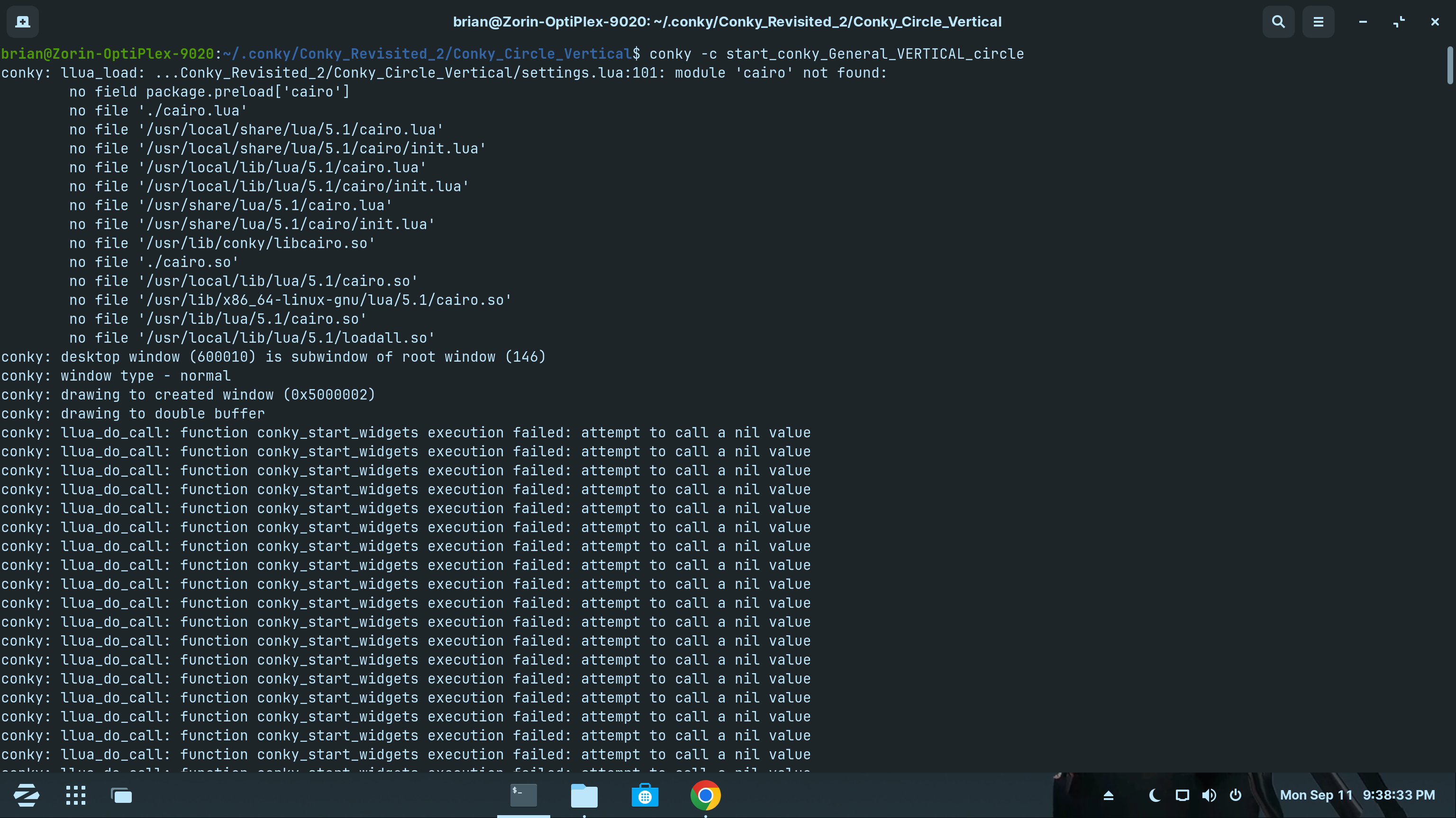

It's making me want to eat nails.
sudo apt install -y libcairo2
Yea, Lua is a whole 'nother thing...
