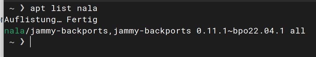

On Zorin 17, You be able to install nala without adding the Repo. You can install it with sudo apt install nala but it isn't the newest Version I think:
