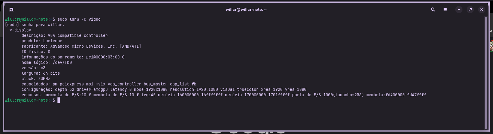

I have not seen this, does it happen with any program running in full-screen or is it a particular one that causes issues? Have you modified any of the taskbar settings?

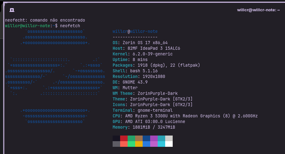

Also, please post the terminal output for
sudo lshw -C video
in case this is a graphical issue.
If using Nvidia, include the output for
nvidia-smi

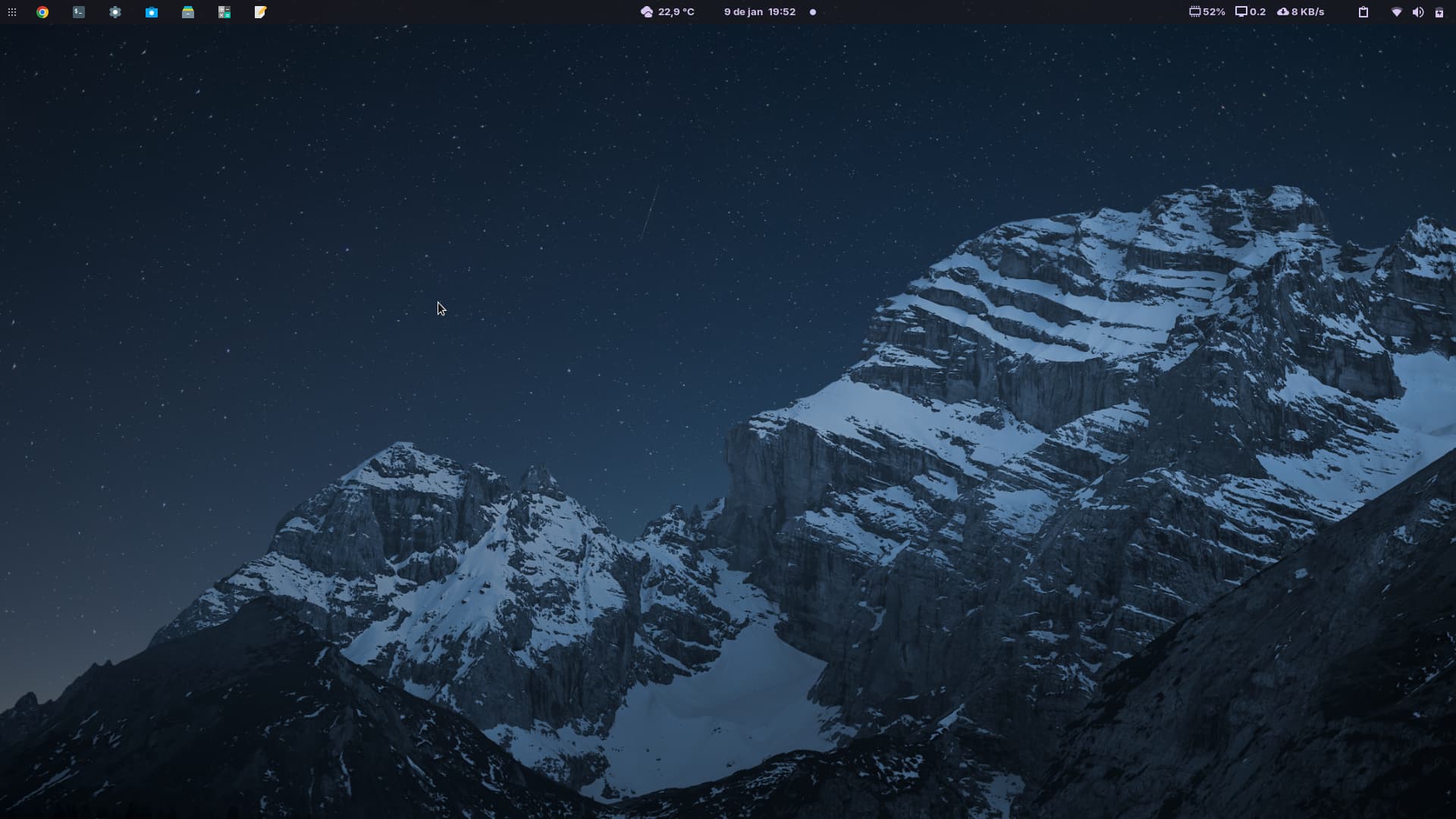

Hello, I made a video showing the Bug, and I realized that it happens mainly with Chrome, but it has happened with other programs.
Follow the link to see the video on Youtube and there are screenshots of other information.

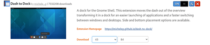

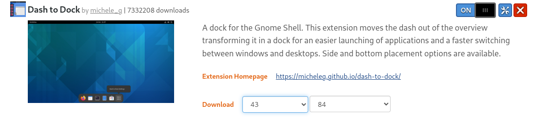

Which version of the Gnome-Shell did you select when you installed DashToDock extension?
Do you have your panel (taskbar) set to autohide?
I installed the latest version available from gnome extensions
Yes, I set it to automatically hide.
I have Zorin OS 16.3 on a Desktop and it doesn't have this same problem
Zorin OS 17 is using Gnome 43; so if you installed the Dash To Dock for Gnome 45 - this may cause issues.
From the Shell Version Drop down menu, is there a Gnome 43 version of Dash To Dock available?
I understand and that could be it.
Yes it is available.
I already downloaded it, I just don't know how to install it
I managed to check, and I'm using the correct version for gnome 43

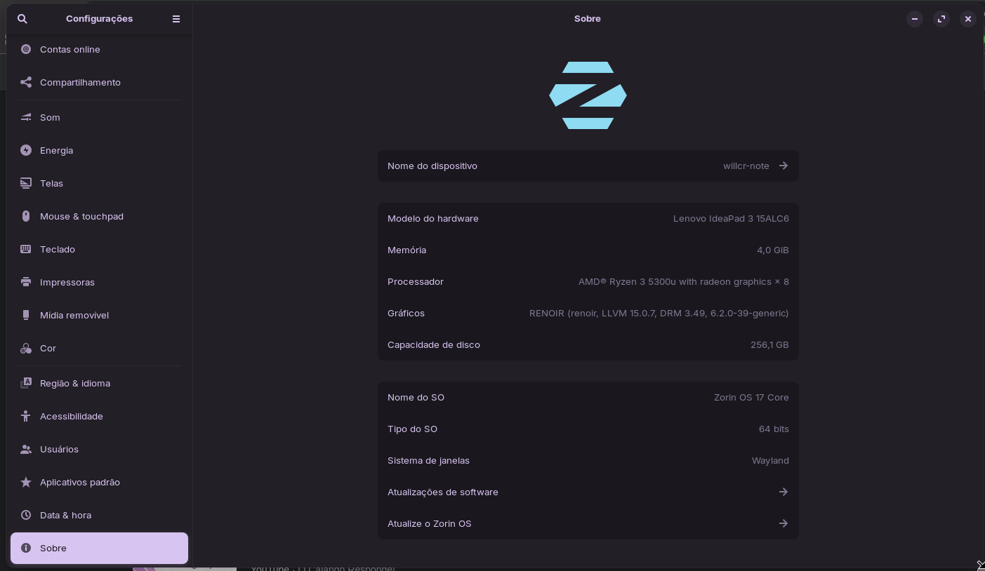

Can you try to login under Xorg? Your screenshot shows that you are using Wayland, which is the new default for ZorinOS 17. Nothing wrong with that, but some software may behave differently.
To change that, log out of your account, click on your username to reveal the password field and on the lower right corner you'll see a wheel where you can choose this option.

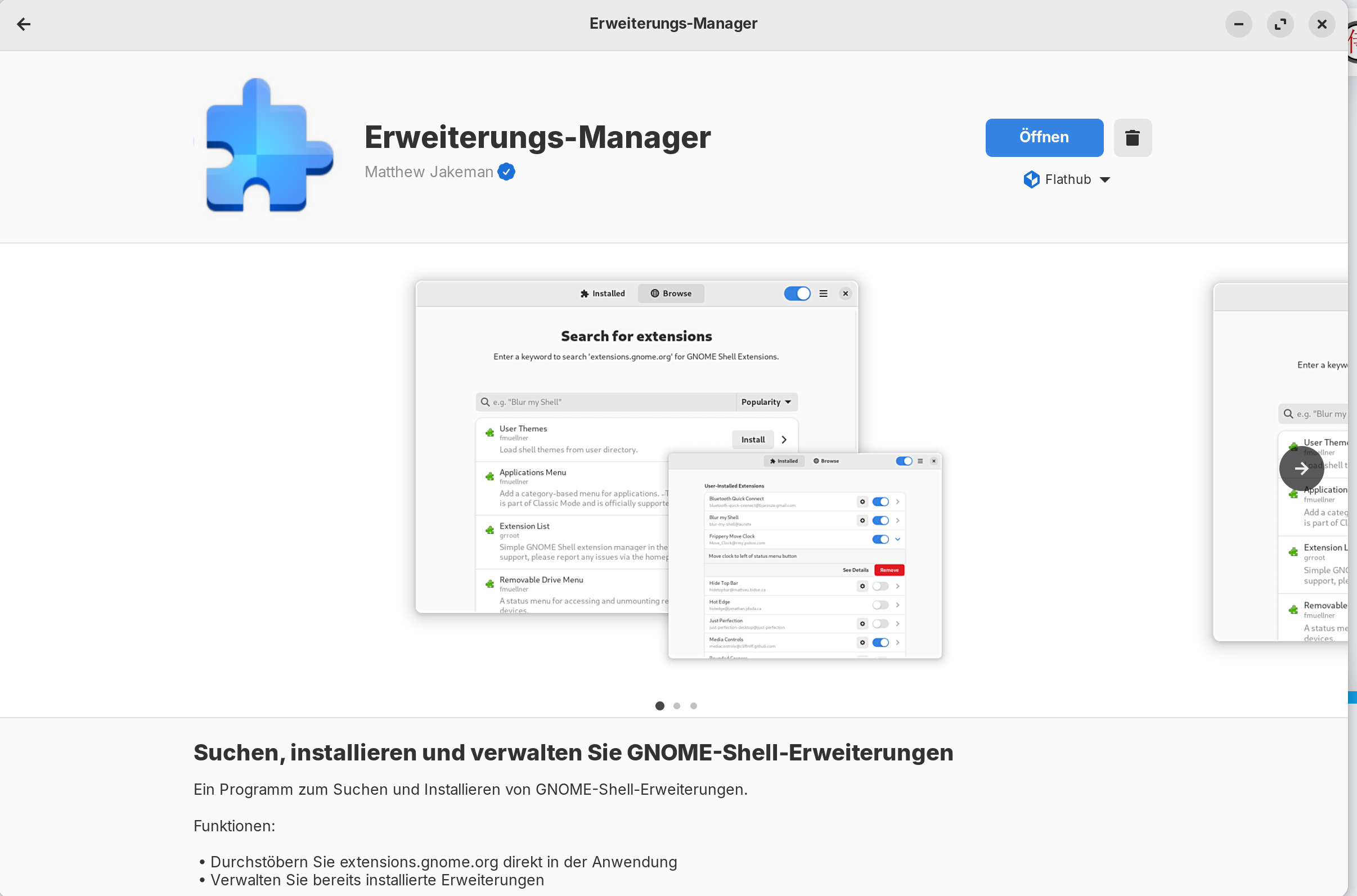

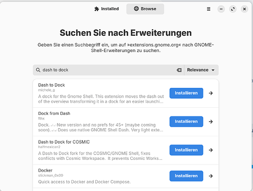

You could try the Extension Manager:
When You use that, you get the right Version for Your System automatically:
