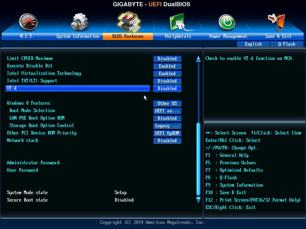

Interestingly, disabling Intel VT-d seems to fix the problem.
I can now run kernel 6.17 without any write errors showing up in dmesg.
I got the idea about disabling VT-d from:
