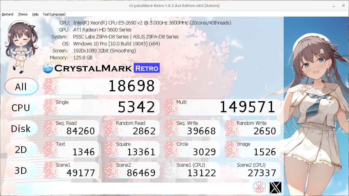

Only thing really good working was Windows 10 Pro after the necessary driver updates. But I'm done with Windows like the most of us here

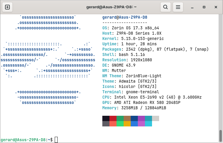

For those who are interested, I finally managed to install Zorin OS on an NVMe and boot from an SSD using an Asus Z9PA-D8 motherboard and a PCIe to NVMe adapter.
Finally 20 cores and 40 threads at 3 GHz on my old junk which still runs incredibly smoothly even today in 2025.
Totally extremely happy with it.
Cheers De-Witte
Extremely happy that I finally got my 2 E5 2690v2 CPU's working and that the Bifurcation for my Lexar NQ 710 1TB NVMe works great by booting from an SSD with the /root mounted on the NVMe.
