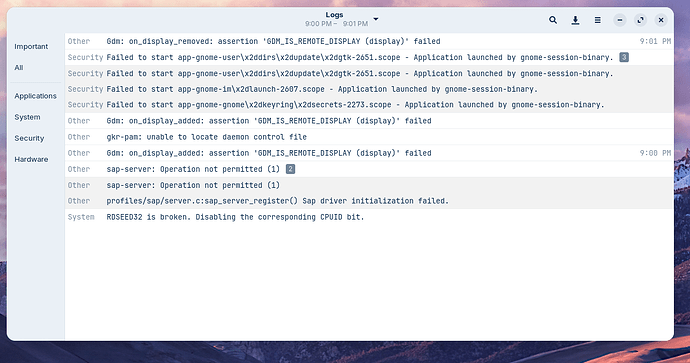

Walked into to all 3 monitors black with one that had a blinking cursor. I could type but now linux commands work. over the last 3 nights every night the computer restarts.
here is a screenshot of the log page after the restart.

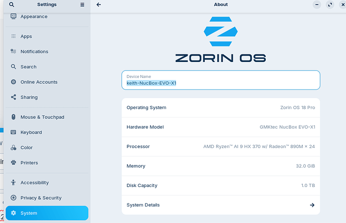

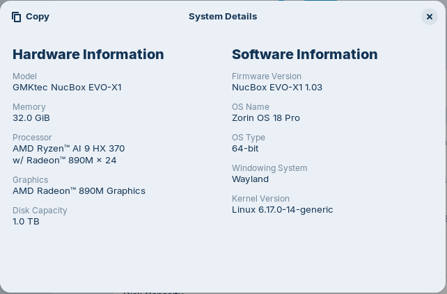

Here is a screen shot of what computer I have Zorin OS 18 Pro running on.

The reference to x2dgtk I did a search on:
" X2dgtk is a desktop application associated with GNOME that is typically launched during user session startup. It is related to the user-dirs-update-gtk service, which manages user directory configuration (like Documents, Downloads, etc.) in a graphical manner.
From the search context, it appears that x2dgtk is involved in a known issue where the system logs errors such as:
  • Failed to start Application launched by gnome-session-binary
  • No PIDs left to attach to the scope's control group, refusing
  • Failed with result 'resources'
These errors are generally considered harmless but can clutter journalctl logs. The root cause is often a misbehaving or outdated .desktop file in /etc/xdg/autostart/ (e.g., user-dirs-update-gtk.desktop ). To resolve the issue, users can temporarily move the problematic file to a backup location (e.g., ~/Desktop/backup/ ) to prevent it from launching at boot—but caution is advised , as removing essential autostart entries may affect desktop functionality.
The name "x2dgtk" likely stems from a URL-encoding of x2d (which stands for "x-dash") in log messages, where x2d is a hex representation of a hyphen (- ), so x2dgtk is effectively x-dgtk , a shorthand for a GUI-based user directory updater.
This appears to relate to X, the display server not initialising.
Whilst I positively dislike Wayland, see if changing to that helps.
To check what display protocol is being used, open a terminal by typing terminal in menu search bar and enter:
echo $XDG_SESSION_TYPE
It is already run in Wayland:

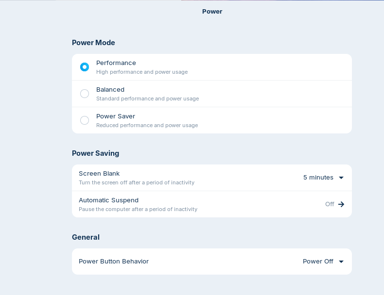

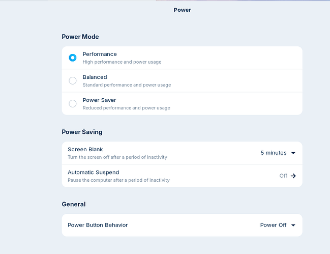

I have changed the power settings to performance and it still restarts

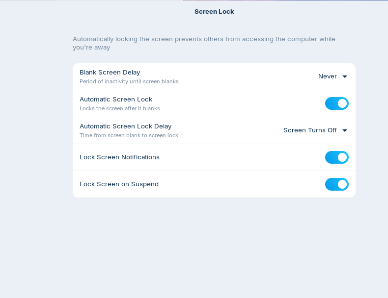

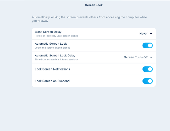

Only to have asked that: Did You checked the Monitor Settings of each one? And when You go to Setings>Power and Settings>Privacy>Lock Screen how are these set up?

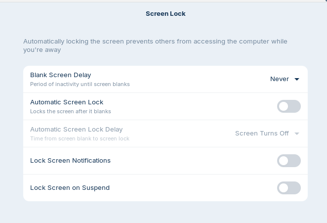

Try it with disabled ''Automatic Screen Lock'' and/or ''Lock Screen on Suspend''.
I made these changes last night.
and the computer did not restart last night.
so this fixed it. Thank You very much.
