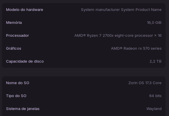

my specs are on the print below
First: I recommend you switch from Wayland to X11 (Xorg). Zorin is an LTS that uses older, reliable components that don't play very well with Wayland. That's probably not the source of this specific problem, but it may be, and it'll likely save you hassles in the future.
Edit: Sorry, I didn't tell you HOW. At the login screen, after you click your name/hit enter to select your user, in the bottom right corner you'll see some icons. As I recall, the one you want is a gear. Clicking it will give you the options of Wayland or X11. Choose X11, then log in as normal.

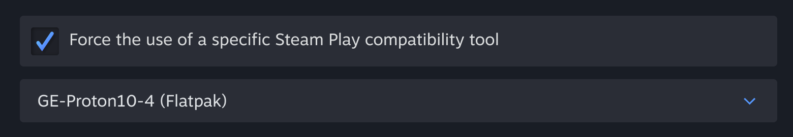

Second, have you set a compatibility tool for the games you're trying to run? You can do that by right clicking a game and choosing properties, compatibility, then selecting a compatibility tool (these are usually called "runners" in launchers other than Steam). I'd start with Proton Hotfix, avoid Proton Experimental (it really is experimental these days; unless you must, I wouldn't use it), and then try each other option successively--but odds are that hotfix will work if compatibility tool is your problem.

I had set the compatibility through Steam's settings in the Compatibility tab to use Proton (as I did when briefly used Bazzite), but nothing seemed to work. Then after your second tip I tried changing in each game to use Proton, then Celeste opened without errors, but the others no. I'll try and test the other runners to see if it changes something for the other games, much thanks.

Glad it helped for one at least. The only times I've experienced errors like yours are when I have a problem with an Nvidia driver, but I see you're using a Radeon. I'm not sure what to make of that; AMD is by and large the less troublesome manufacturer on Linux. I'll step back here and hope someone with AMD experience is familiar with your problem and can help.
To anyone who steps up, the RX 570 is a desktop card, circa 2017, so older, but not ancient, integrated, or otherwise out of the ordinary.

First, I use Flatpak Steam...
Second, scroll down on the install page in software store, you will see this too...
Make sure you put checkmarks in at least:
Proton-GE
Once Steam has been updated with the community GE Proton packs, launch Steam, and right click a game, and go to the compatibility tab. Put a checkmark in force Proton, and choose a Proton version...
Please note, depending on age of game or machine, the game might require an older Proton version. But it is advised to start with the latest first, and see if it launches the game.
There are rare times when standard Proton versions won't launch the game. Thats when you add a glorious eggrole to the mix, using some of that sweet delicious Proton GE pack.
