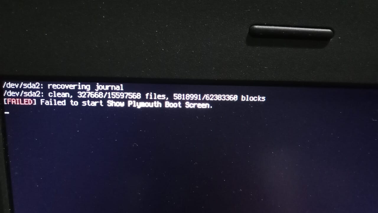

Failed to start: Show Plymouth boot screen
what is this now?
There are several things that can cause this.
Physical Issue: Check your RAM and HDD or SDD plug in/ contact points.

So I had the ISO file with me which I've used for installation, installed quickhash and checked integrity of iso file, it matches the hash checksums listed in zorin website. also I remember I didn't skip filesystem check during installation. also, unlike the flashing issue that I,ve had in previous post, now the system doesnt't boot up at all. it stays on the screen in picture, and it have be forced shut down(pressing power button for 5 sec) and power on the system.

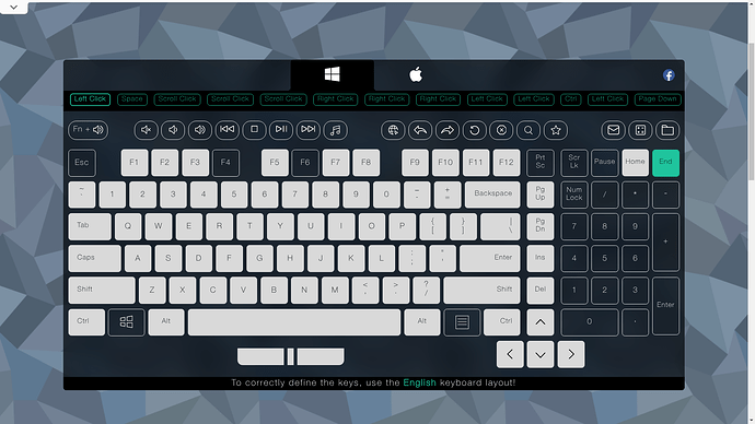

Yep it feels like f4,f6 and end is sad, there must be something under those keys. also end key explains the 2nd case, it does have the behavior to lock pages at the ending.
there were some important files in the system which i've already moved so no problem in reinstalling OS. tomorrow I would open this up to clear the keyboard. don't know what is causing the key to stay pressed, although I don't see any debris there, its kinda stiffer than others.
I should first resolve the end key issue, then if some problem still exists, we shall look forward to ssd/ram issue.
