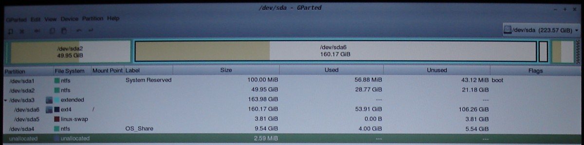

I am going to put Zorin on my older ThinkPad (T500) for my husband to use. Here is a Gparted view of the hard drive on it -
This laptop was set up as a dual OS set up with Windows 7 and Linux Mint (then) 17 + an 'OS Share' partition where I could transfer files between Windows and Linux. A few months ago the Windows 7 OS went flaky, not operating at all. I had updated to Linux Mint 19 along the way and with that soon to be unsupported, would need to update to either 20 or 21. I do NOT enjoy updating - done it toooo many times gnashing teeth and pulling hair all the way (lol). So I thought, hey why not try Zorin (on new Lenovo) laptop and not mess with a Linux update. (easier to load an OS than update :wink:
So now I want to add Zorin to the old ThinkPad but I don't want to wipe the wrong partition! I am thinking that dev/sda2 is the Windows 7 partition and that dev/sda6 is the Linux OS with dev/sda5 the (Linux)'swap' partition. IS THAT WHAT THIS LOOKS LIKE TO ANY OF YOU?

Thanks for those instructions zaba, but I still would like to replace Win7 with Zorin! Am I correct that dev/sda2 (see first post here) is the Win7 partition?
Yes sda2 is the Windows Partition - you could also get rid of sda1 which is the Windows System reserved area. I know what you mean about Windows 7. When I was working I took advantage of the subsidised Windows 7 Ultimate. About 6 months before end of life a 'security roll up' screwed up the updates so I never installed it as it always screwed up Windows 7. When you install Zorin, do a manual install. I would aim for 30 Gb as '/' and then the rest as '/home' - make sure that '/' is flagged as bootable (boot) on the flags bit. I would also second the idea that you would be better getting something like an M2 SSD which is what I did on an old Dell Latitude E6500 and increased the RAM from 2 Gb to 8 Gb. Sadly I could not get Zorin Education to play nicely on it and had to resort to installing Windows fx. The only issue with putting Linux on an SSD is that you can't update the firmware as they are dependent on Windows - well Crucial is anyways. Don't know about other manufactureres. I would avoid the PCIe NVMe type of SSD as a member of the local Linux User Group did on his notebook and it cascaded all the time rendering the SSD useless.

Where is the boot partition? Isn't sda1 usually used for that?
You would mark '/' as the boot partition - the system reserve of sda1 is to boot Windows.
I'm really feeling like a dolt pest, but I am trying to understand before I do what I need to do to get Zorin on this (older) ThinkPad.
Do I simply reformat the sda2 and sda1 partitions (to ntfs) and install Zorin onto sda2? Will the '/' boot partition pick up on the new Zorin as well as see the Linux Mint option for booting?
File system for GNU/Linux needs to be Ext4 not NTFS. When you instruct the installer to place GRUB on '/' after installing it should pick up Linux Mint. If it doesn't just run the update grub command which will make it search for other OS's and add it to GRUB menu for next boot.

Now I am really confused - I just looked at Disks and it shows a different image than it did last week - with the 'linux' area Free Space! Yet the Linux Mint that is on this drive remains working. Gparted shows Mint as dev/sda6 & 5 [swap].
How can Disks and Gparted be so different?

The screenshot in your O.P. shows Windows as being on sda2 with Linux on sda6. You have a swap partition set up on sda5 (Which may be necessary only if you are using Hibernate manually setup.)
I wonder if Disks is struggling with the Extended partition.
