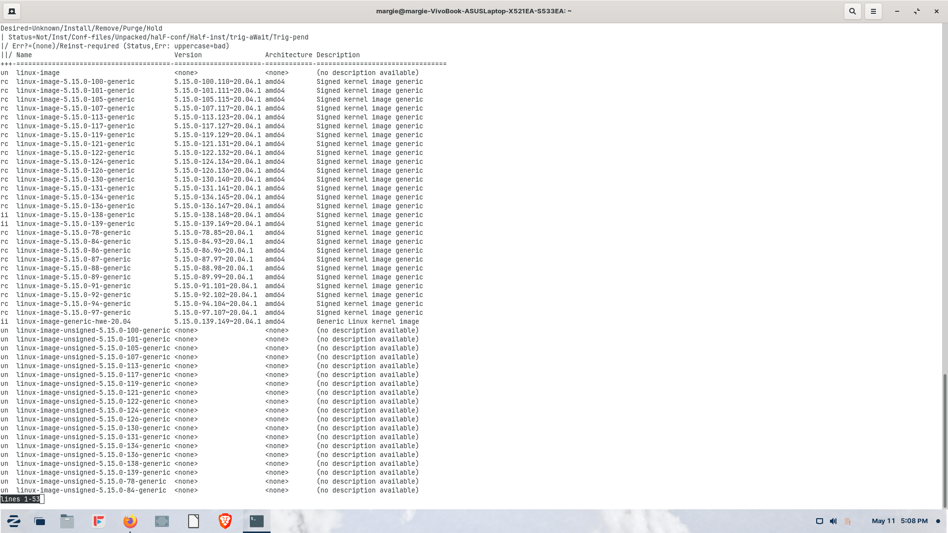

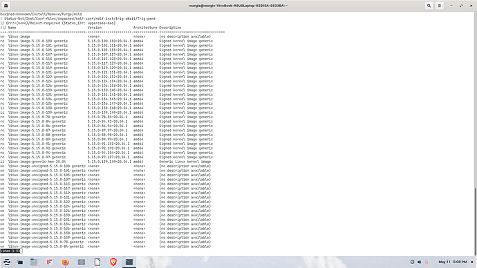

dpkg --list 'linux-image*'

That is a lot of old kernels taking up a LOT of space. We should clear most of those out (Leave one, though, as a fallback in case you need it.)
sudo apt remove --purge linux-image-5.15.0-100-generic linux-image-5.15.0-101-generic linux-image-5.15.0-105-generic linux-image-5.15.0-107-generic linux-image-5.15.0-113-generic linux-image-5.15.0-117-generic linux-image-5.15.0-119-generic linux-image-5.15.0-121-generic linux-image-5.15.0-122-generic linux-image-5.15.0-124-generic linux-image-5.15.0-126-generic linux-image-5.15.0-130-generic linux-image-5.15.0-131-generic linux-image-5.15.0-134-generic linux-image-5.15.0-136-generic linux-image-5.15.0-138-generic linux-image-5.15.0-78-generic linux-image-5.15.0-84-generic linux-image-5.15.0-86-generic linux-image-5.15.0-87-generic linux-image-5.15.0-88-generic linux-image-5.15.0-89-generic linux-image-5.15.0-91-generic linux-image-5.15.0-92-generic linux-image-5.15.0-94-generic linux-image-5.15.0-97-generic

So, I typed in the number I thought it was, 126, but it said it was unable to locate package linux-image-5.15.0-126. That was one of the ones I messed up on. I don't remember the other one right now. Is it important I get all the numbers you included purged or included? I will retype the whole thing again if I need to.
That was a lot of kernels. I think if you got the majority of them, that is sufficient space cleared to boot normally.
Once booted, you can use
To see what is left over, then can employ copy / paste to catch the stragglers.

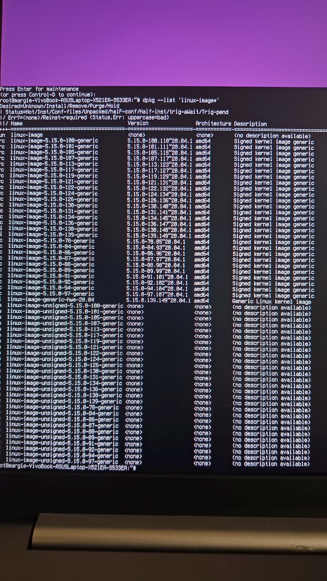

I figured out how to get a command prompt and this was the outcome of the dpkg --list 'linux-image*'
Your earlier attempt to remove all those spacehog kernels did not remove any of them due to a typo.
You can remove them again in this terminal, all at once and carefully checking for typos, or one at a time.

So I found it should be the maintenance choice and I entered the first number.
The response was a red capital E: unable to locate package linux-image-5.15.0-100.
Under this another red capital E: couldn't find any package by glob 'linux-image-5.15.0-100'
Did you forget the -generic?
