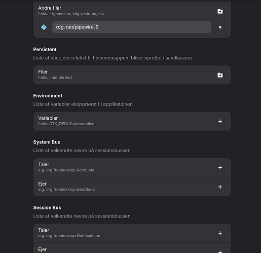

Referring to my previous thread I did try getting FP-Reaper to work using Flatseal (thanks @Ponce-De-Leon ), but all I know to do is turn on everything that isn't on - I don't know how to use the other options (screenshot below, in Danish but I think the option headers are the same).
I suspect that it might be something about adding certain file paths - also, I saw somewhere that permissions for Wine, which for Zorin I assume means Bottles, also have to be modified in Flatseal. But which & where?
