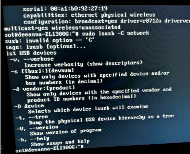

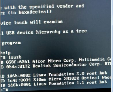

![lsusb|386x313](upload://dFHGCSk0g9rADksOE0pK62ENLeR.jpeg
Due to the invalid -C... I did it again without it but still it didn't say anything
about chip set.
I will try to determine what chip set is in the pc in the morning and put it here for you... give me any info that you think might help my search.
THANK YOU!!! ok.. i will go back and try again
heh

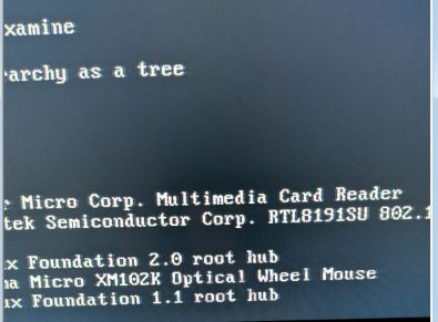

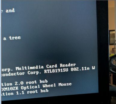

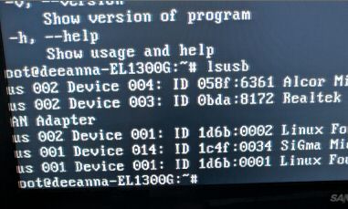

Just
lsusb
That is the whole terminal command.

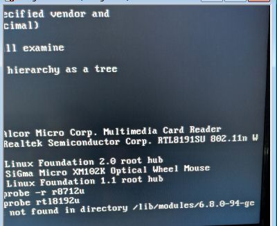

Pics go left to right with some over lapping .... is this what you need?

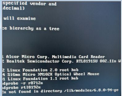

Can you try:
Unload the staging driver:
sudo modprobe -r r8712u
See if the stable(r?) driver will load:
sudo modprobe rtl8192su
Do I do these commands one at a time after a response?
Yes, one at at time.
need clarification on last one.. rt?8192su what is question mark?
I placed that with the r as in
stable
vs.
stabler...
As in stabler than the unstable 8712u, buit might not be very stable, either.
That particular networking card has poor driver support, over-all.
I cannot read what it is... is it a i or a l ?? THANK YOU!
It is an "L"
RTL8192SU (Only, do not use capital letters in the actual command)
Hard to tell from your photos, but it looks like the 6.8 kernel does not include the 8192su module... I know it is deprecated. It may have been dropped by the 5.15 kernel...

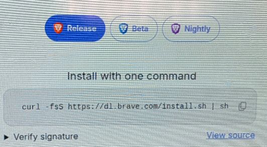

Of course, I click on Brave... the photo shows you what is on my screen
right now... so what do I do now?
I do not understand the line after the sh
Is that the line above the ENTER KEY?
Copy and paste that line in the terminal. Hit enter.
