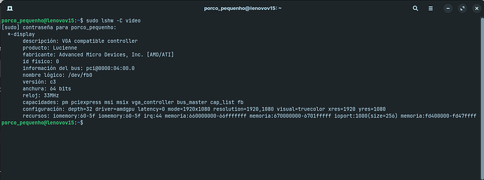

Can you please open a terminal (Menu | Utilities | Terminal) and enter:
sudo lshw -C video
and post back the results please.
I have a Ryzen 3 5300u whit Radeon Graphics, RX Vega 6
Having researched Ryzen 3 5300u is one only released this year. Are you on the current kernel of 6.8 or earlier?
