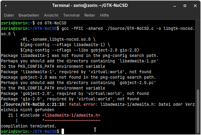

Does anyone have experience with it - is it any good, and how do you compile it? I’m getting error messages.
I don´t know if I must just copy the command shown on codeberg or if I need to change something when I enter it in terminal (because of the \ signs)
Have you searched in Synaptic Package Manager for the missing objects?
It wants some Dependencies. And from the Link, I can see that it wants some additional one's, too. You could try this:
sudo apt install make gcc golang-gir-gio-2.0-dev golang-gir-gobject-2.0-dev libadwaita-1-0 libadwaita-1-dev
and then try it again.

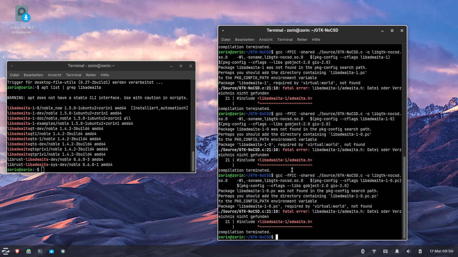

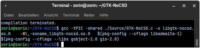

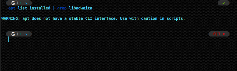

I'll try that. Until now, I took a look at synaptic and installed something with gio-2.0. Now that error message is gone, but libadwaita error is still shown, but it is installed. I tried various cflags, but didn´t help:
Thank you very much, now it worked. No errors shown. I'll see, how to proceed.

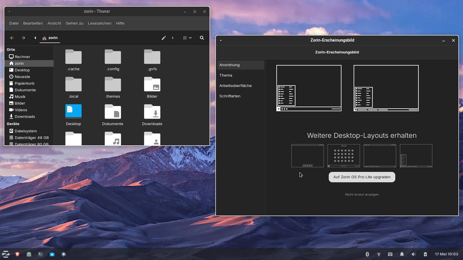

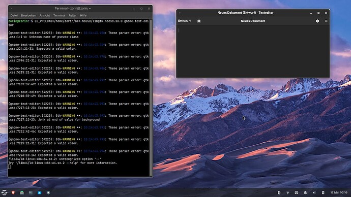

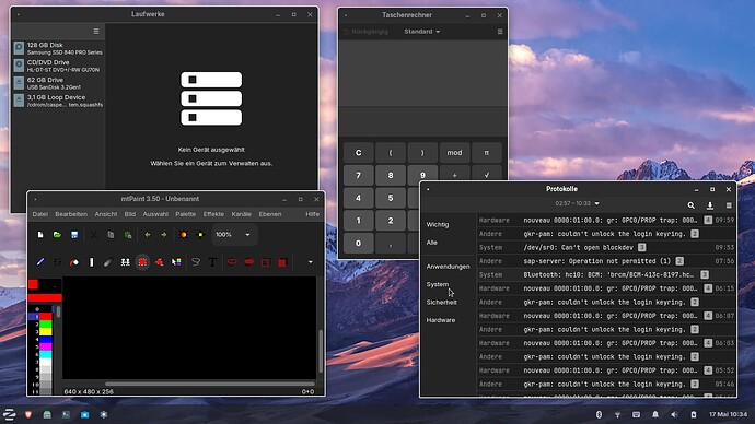

Thunar and Zorin Appearance have the custom graphite xfwm theme now :smiley: , but text editor, gnome-software or calculator not.

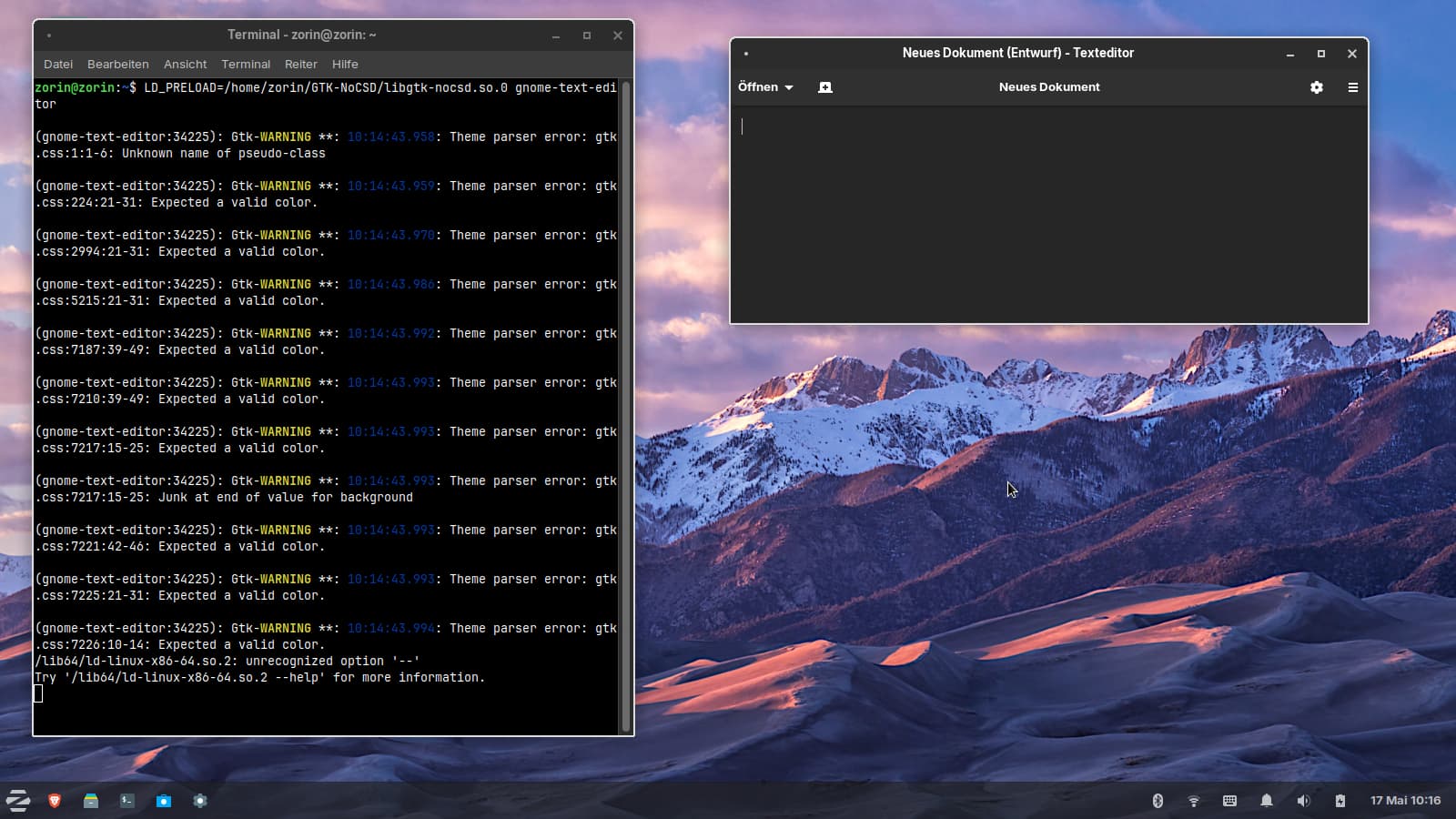

Now gnome-text-editor shows the xfwm theme launched with
LD_PRELOAD=/home/zorin/GTK-NoCSD/libgtk-nocsd.so.0 gnome-text-editor
from terminal
, and also gnome-calculator, gnome-disks, gnome-logs and others work with this method launched from terminal, but gnome-software still doesn´t work. I'm happy with the result for now (test was in Zorin 18.1 Light live session).

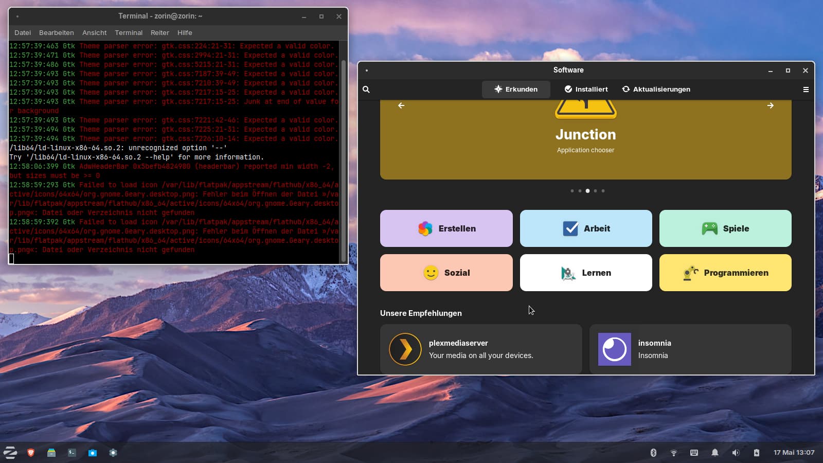

For gnome-software I tried a way which was shown on the github site: The removal of the line "DBusActivatable=true" from the gnome-software .desktop file and then tried to launch it from terminal with the LD command. A long while nothing happened and errors were shown in terminal, but then gnome-software opened with a white frame!
Now I've made some progress - on the one hand.

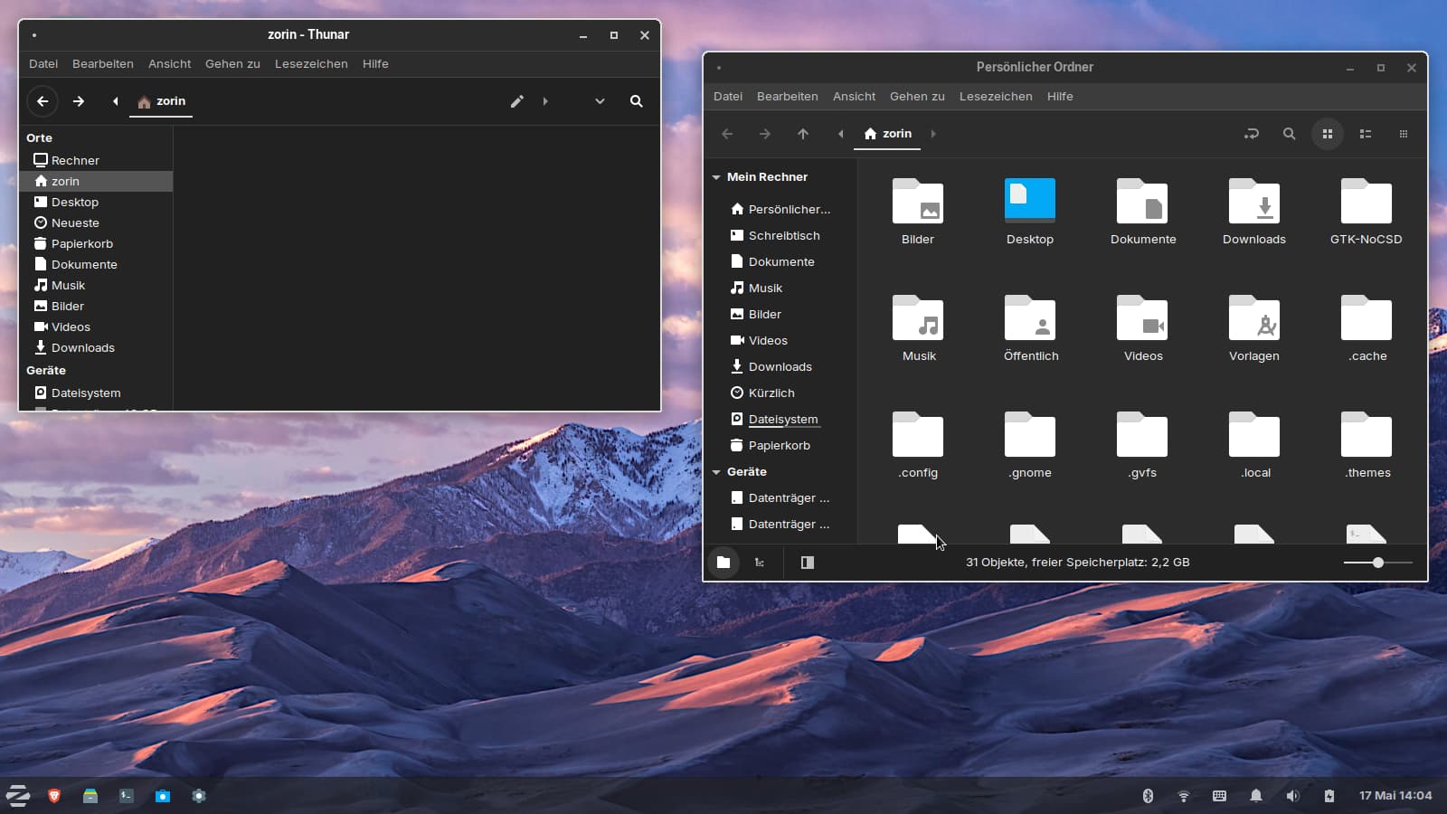

When I enter thunar in the search field of start menu, thunar opens, but is empty and shows no folders:
Nemo which I have installed, too, works.

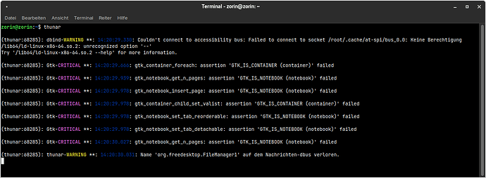

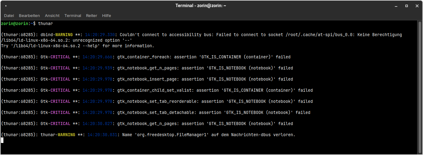

How can I repair Thunar? I tried to reinstall, but didn´t help. That is the terminal output when it is launched from terminal:
"Couldn't connect to accessibility bus: Failed to connect to socket /root/.cache/at-spi/bus_0.0: No permission
/lib64/ld-linux-x86-64.so.2: unrecognized option '--'
Try '/lib64/ld-linux-x86-64.so.2 --help' for more information."
I repeated the installation of the program in a fresh Zorin 18.1 Lite session, but again the problem with Thunar showing no folders/files (nothing at home and nothing at filesystem root) at all appeared. The user-dirs.dirs is right, I didn't change something there, and Nautilus and Nemo work normal. I set Nemo as default file manager to see if that would help, but didn't change anything in Thunar.
Does someone have an idea why that happens? What is wrong with that environment variable? Shall I put it elsewhere? I tried to put the line to other places as ~/.bashrc and ~/.bash_profile, then Thunar worked again, but the custom xfwm theme stopped working for all apps and the program seemed not to work then. For all other apps it is a good solution at ~/.profile, only for Thunar not.
Putting the line to /etc/environment has the same problem that Thunar doesn't work correctly then.
I noticed that thunar works and shows all folders/files when it is launched as root.

The primary issue you are having is that GTK-NOCSD is being globally loaded in a mixed GTK3/4 environment, alongside of LibAdwaita which hijacks and injects its own hidden .css
Thunar is not broken, GVFS is not broken - and you know this because bypassing it by running it in root allows Thunar to function.
What you are experiencing is a problem I tried to overcome - but could not - due to LibAdwaita's hijacking of the system and rerouting.
