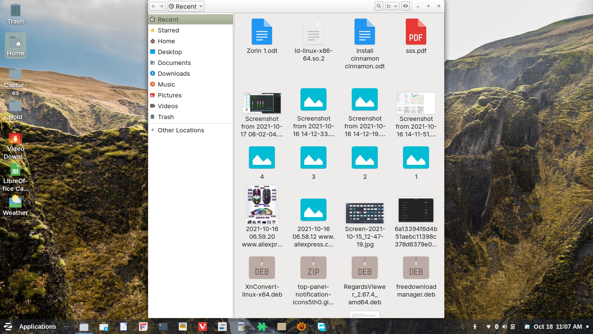

Here is a snapshot of the left side of my screen when I clicked on those three icons .... only the items in the center panel were not there it was blank ... I had to deal with the menu on the far left side starting with recent ... stared ...home etc ...
that is your file manager treeview...
