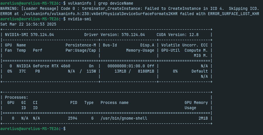

Having lots of trouble getting the Nvidia GPU to work in 17.2
I don't understand how to get Vulkan to work with the NVIDIA GTX 4060. It is using the driver 570 (proprietary) and everything is up-to-date. But, when I run a game through Steam Proton, it is super laggy because evidently it cannot use the GPU.
The ICD file in etc/vulkan was missing so I tried to add it in manually to no avail.
Help appreciated.
I am in Wayland

Probably the gaming part is irrelevant, it's just getting the components to be working properly regardless of task with the dedicated GPU. Anything graphically intensive needs it to work. I hope someone can help me out.
You say you're running Wayland. That'sa no-no when running Nvidia card, even for driver 570. Try switch to xorg.

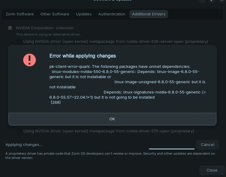

sudo apt install nvidia-driver-550

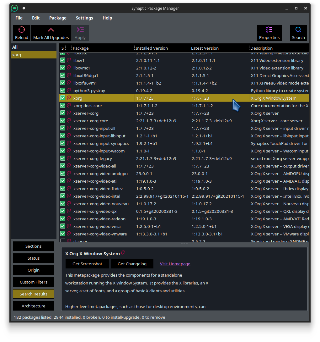

Open a terminal (Ctrl+ Alt+ T) and enter:
sudo apt-get install synaptic

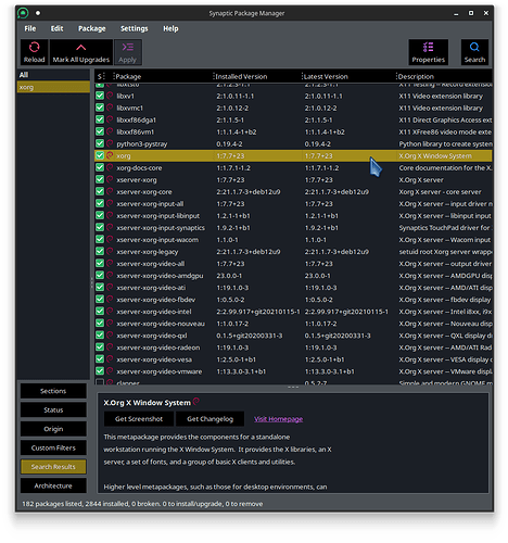

This should install Synaptic Package Manager. Launch it (you will be asked for your login password to elevate you to 'root'. Search for xorg and install that and the nouveau drivers:
Please note screenshot is from PCLOS Debian not Zorin 17.3

ok 550 is selected now
I installed Synoptic. How do I use it to install Xorg?
Click on the Search button near top right and a search dialogue appears. Type in 'xorg' without the quotes. Left click the little square box next to xorg and xorg-server and for each one, select 'Mark for installation' then click on the Apply' button near top left. You will need to enter your password to elevate you to 'root' when launching Synaptic.
I marked them for reinstallation and did it, logged out and now the gear icon is nowhere to be seen lol. I might have to just reinstall the whole OS
