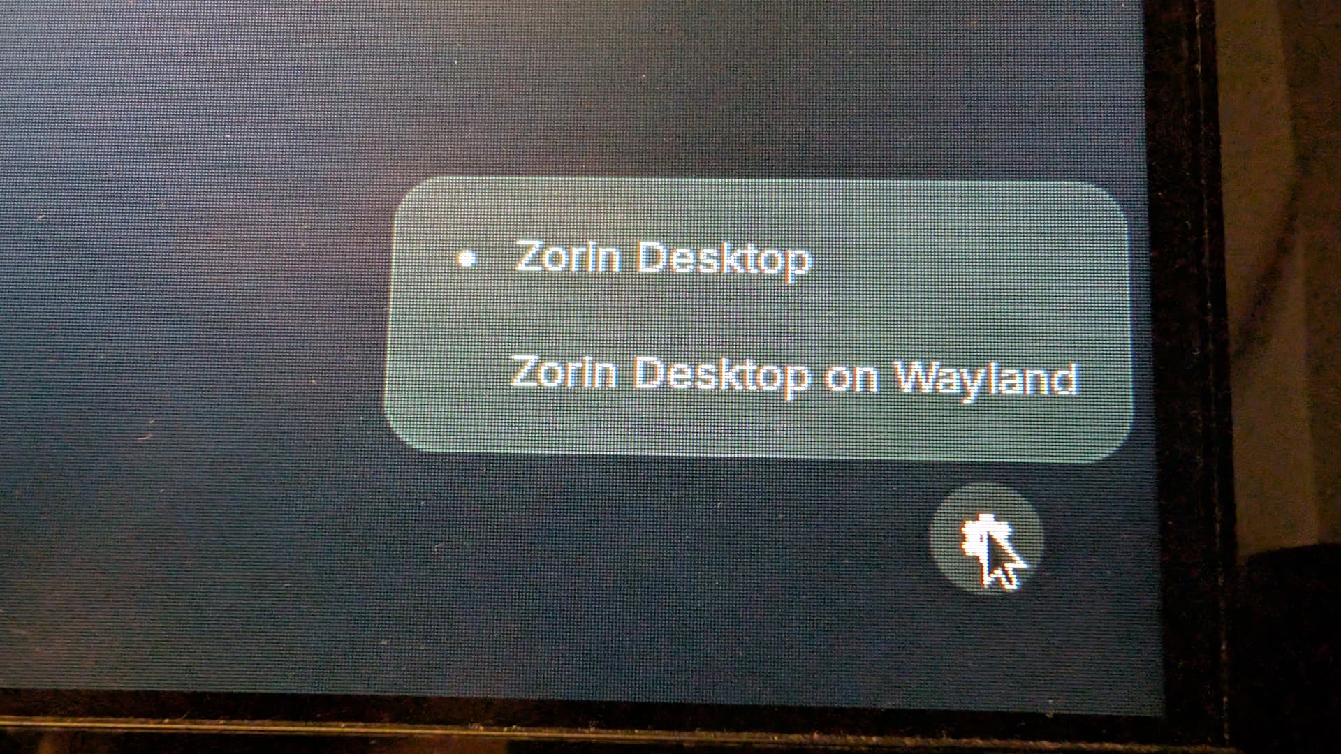

I found the gear icon, but it no longer says Xorg and when I select it and log in, it just puts me back in the log-in screen. Not working.
It is not clearly labeled. But that would be the Xorg option. And if you like, Wayland can be disabled in order to ensure logging in on Xorg; so that is not a major concern.
That you are getting punted back to the login screen is a bigger concern at the moment.

After following all instructions, there is still no gear at login, it's gone.

Because You have an Nvidia Card, in Your Case it is reverted. that can happen when You install Zorin with Nvidia Drivers for Example. So:
Zorin Desktop = Zorin Desktop on Xorg
Zorin Desktop on Wayland = Obviously Wayland.
