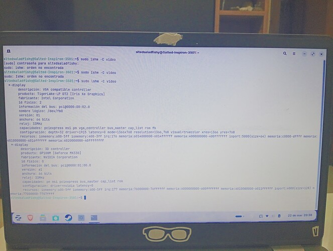

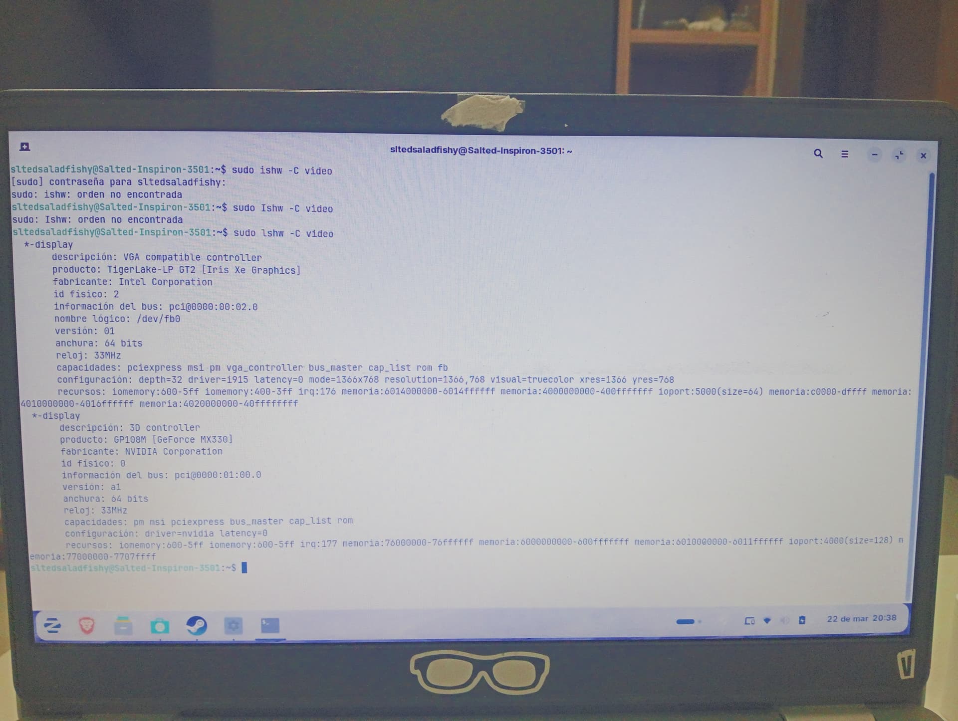

Please remind of what GPU and drivers you are using:
sudo lshw -C video
Sorry ofr uploading like all, i didint know what was the gpu in the list

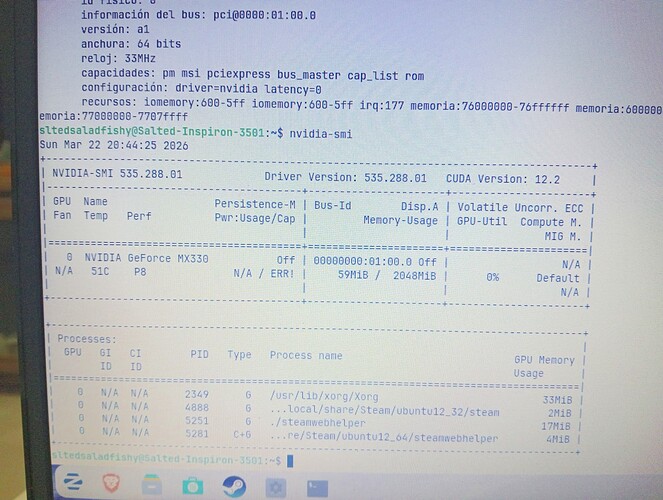

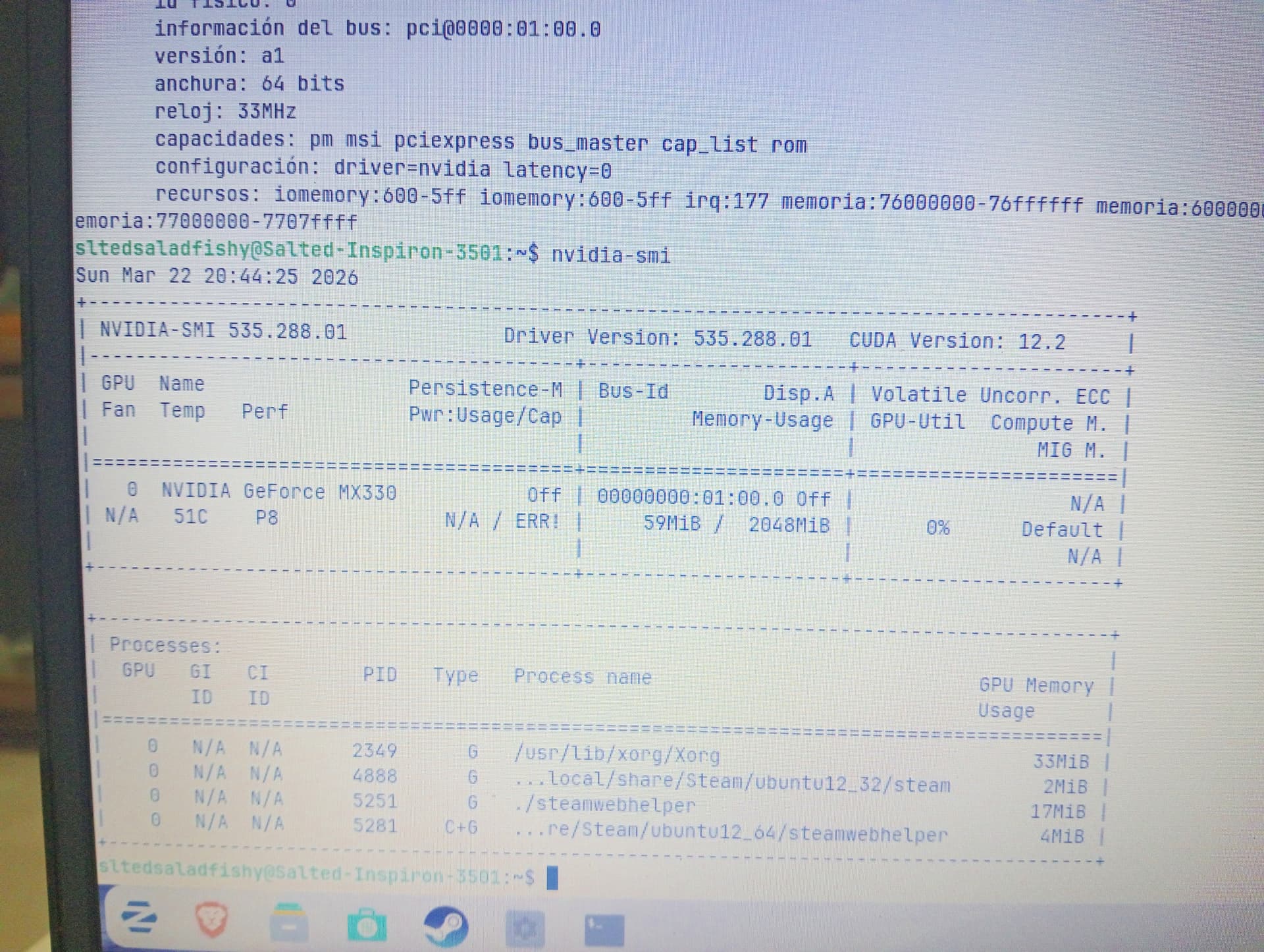

The intel looks fine. What about the Nvidia?
nvidia-smi
Will Brave Browser launch with Hardware Acceleration and GPU disabled?
