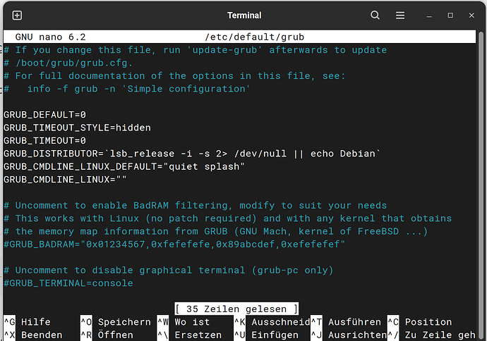

If You shouldn't have a GRUB Menu because You have only Zorin installed, you have to activate it first. For this open the Terminal and type:
sudo nano /etc/default/grub
Then You should see this:
Important is here the white Textblock. You have to change 2 Lines:
  • GRUB_TIMEOUT_STYLE=hidden
  • GRUB_TIMEOUT=0

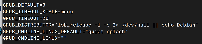

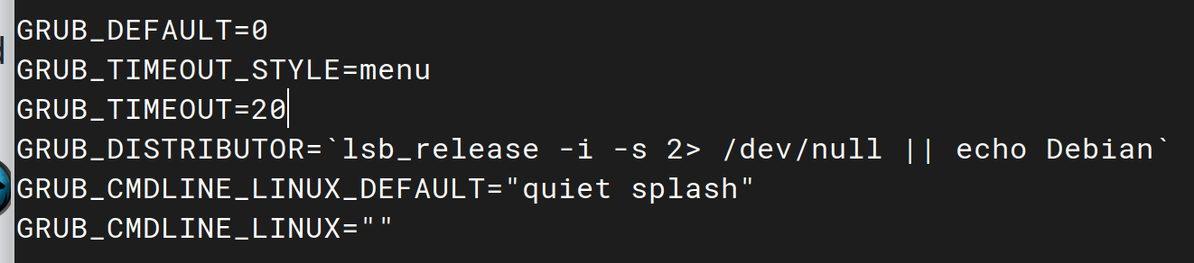

You have to replace hidden with menu and the 0 with 20 for Example (this is the Time how long the GRUB Menu will appear before it disappears and starts with default). At the End, it should look like this:
After You've typed in the Changes press ctrl+o to save the Changes, Enter to confirm and ctrl+x to exit. Back in the normal Terminal Overview don't forget to type sudo update-grub to make affect the Changes. Without that, it will not work.
