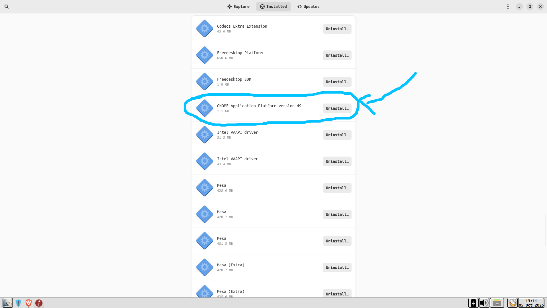

I saw this in Software app, do you htink its safe to delete it?
That is a dependency for a Flatpak package.
Whenever you see a Gnome dependency in Zorin OS 17 higher than Gnome 43 - or in Zorin OS 18, higher than Gnome 46, it is a flatpak (or maybe Snap) dependency.
If it shows as installed, it may be that a Flatpak you installed pulled that dependency in. You would need to first check if you have and are using any Flatpaks that you installed that depend on it.
If you have installed no flatpak packages at all... and have no intention to - you can remove it all you want.
