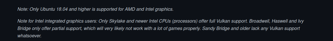

Looks Like a Warning, To Stop users with Ubuntu lower than version 18.04 updating to the particular driver. But, No worries Zorin is 20.04 ![]()
