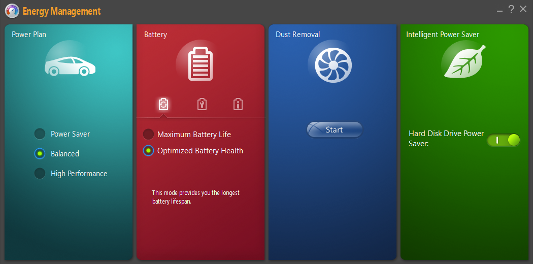

I suspect the OP was enquiring about a battery management app similar to this Lenovo one. In Battery Health mode it keeps charge to 60% when plugged in.
We have had this conversation about battery management app on Linux desktop in the past and concluded there was nothing like this available.
