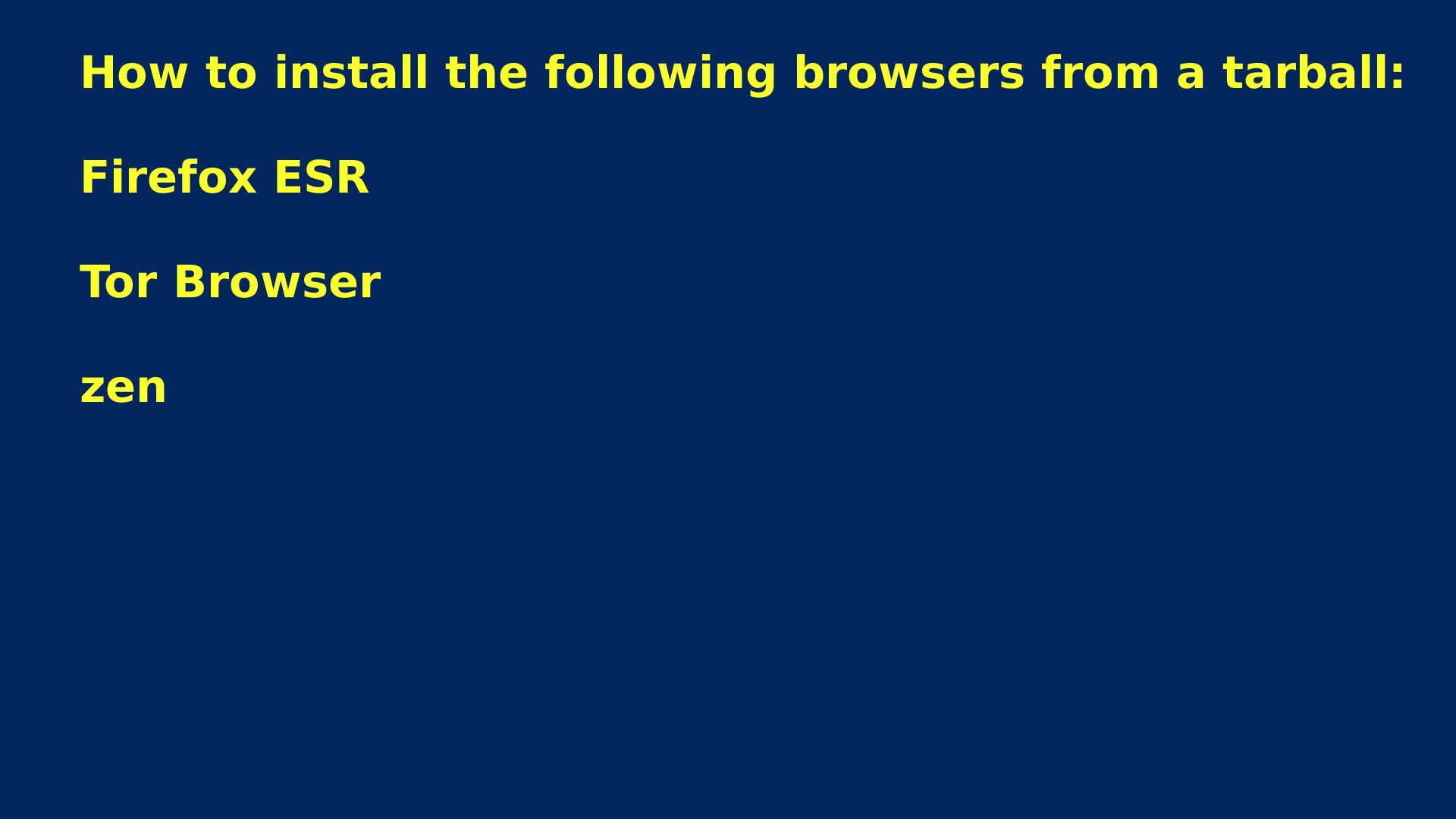

I have already exolained elsewhere how to install Firefox ESR, Tor Browser and Zen browser quite easily.
  1. Extract the tarball with Ark/File Roller.
  2. Go to the extracted folder and search the cog icons in that folder for the browser name (firefox/tor/zen).
  3. Use Main Menu to create a new entry under Internet, in this instance, zen.
  4. In the command box to launch, browse to the cog icon named zen in the extracted folder.
  5. To add the zen icon in the blank space for one, go to the extracted folder and open the sub folder browser | chrome | icons and choose 'default64.png
You can now add zen to Dash from the Menu.
Updating can then be done as you would in Windows; Help | About and it will then check for updates.

I find it difficult for Linux beginners (and also for me, because I found no readme file, no installer script in the tarball) and you need to create a .desktop file and (if you like to save it outside from Downloads) a new directory/folder where you save zen. With your explanation it is clear now.
I will do a video for all three browsers.
You cannot add to desktop or Dash before creating Main Menu entry.

Here is the video as promised. Forgot that Tor needs a slightly different approach!
It has taken me about 6 attempts to get it right!

Swarf thank you so much for all that hard work I wasn't aware that Applmages couldn't be auto updated ... Ponce gave a solution in his post above even if it is a flatpak app just in case I can't get my head around your fantastic video ....
I downloaded it ... I hope you don't mind.... so I can follow it more slowly and enlarge it a bit .... have a bit of a problem with my eyes .... kinda like the lyrics in the song about " the leader of the band is tired and his eyes are growing old" .... LOL
