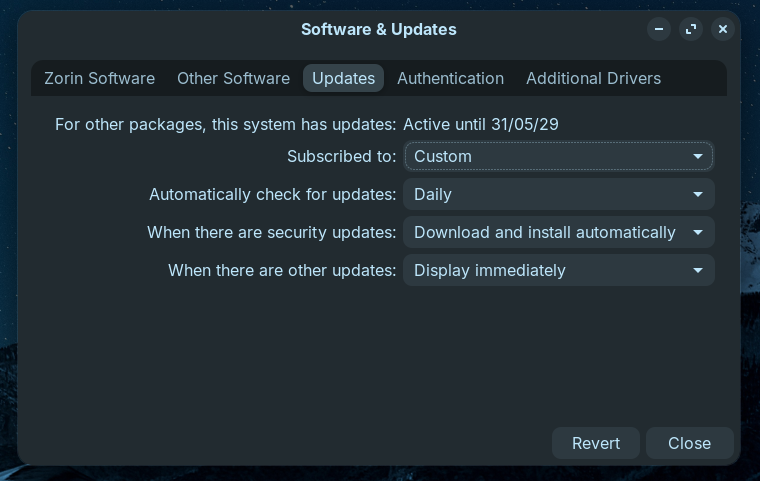

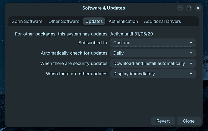

You can activate it. Go to Software & Updates and there to the middle Tab. There You can set up automatic Download and Installation.

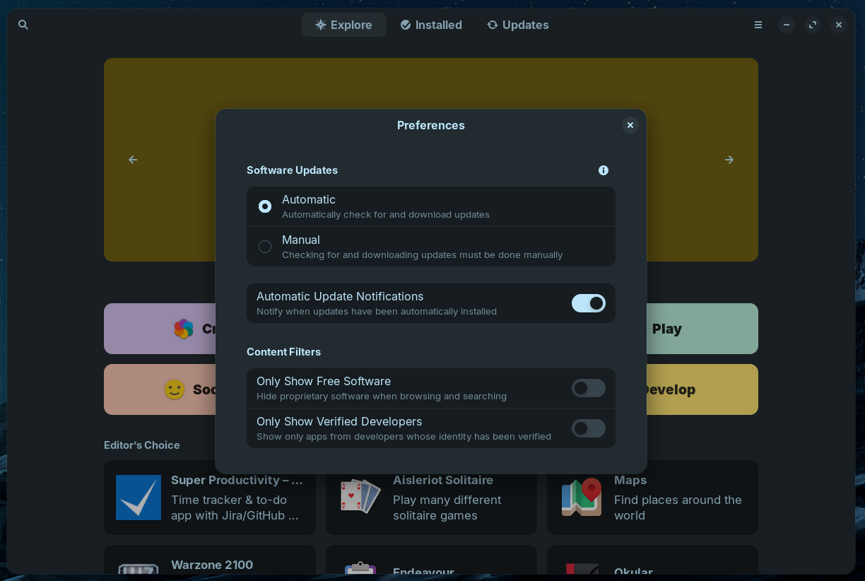

And then there is another Place. Open Gnome Software, click on the Hamburger Menu left beneath the min/max/close Buttons, choose Settings and there You can activate Automatic Updates, too.
How can I tell if it does something, is there a log? I did these things right after install, but I don't think it ever updated something. From unattended-upgrades log it looks like it didn't update anything in two months.

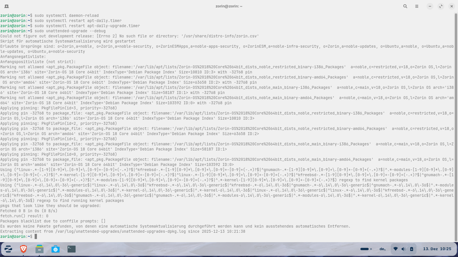

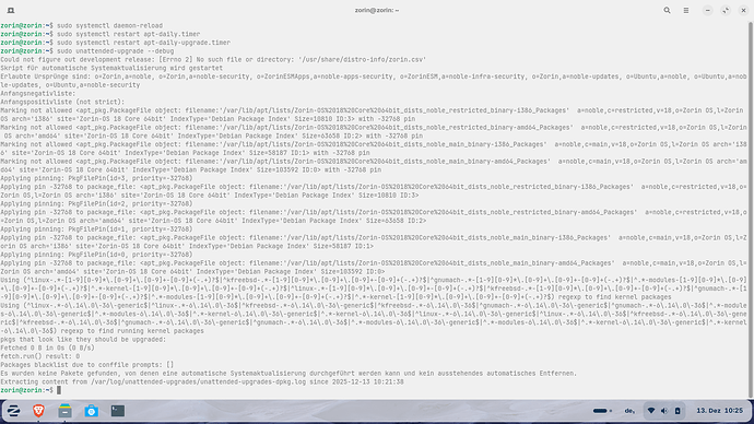

I don't see anything upgraded either. Every check ends with:
"INFO No packages found that can be upgraded unattended and no pending auto-removals"
Still nothing 2 hours later, I let it run for 2 hours to see if something happens. The first messages in the log are from oct. 15th, it didn't install anything according to this. Did this ever work for anyone? Everything I found, had the same answer, just toggle this and that, no responses for further questions.

here's the gui config
for some reason I can't change the Custom value, it asks for password and nothing happens
here's the other one:
unattended-upgrades is installed with Zorin 18. If the log file has entries, it's working. The reason you don't see any packages being upgraded by it is that the allowed sources are restricted to Zorin repository only:
From the script's output:
INFO Allowed origins are: o=Zorin,a=noble, o=Zorin,a=noble-security, o=ZorinESMApps,a=noble-apps-security, o=ZorinESM,a=noble-infra-security
If the Ubuntu repositories were included, you would likely see more packages being upgraded this way.
Yeah, this is what that linked reddit post says, but that's the only place I saw this and I'm not alone. Maybe the package was installed I don't remember.

I let the system run 8 hours and still nothing 08:22:25 up 16:55, 1 user, load average: 0.11, 0.09, 0.09
I tried to setup unattended upgrades which included the ubuntu repository as described in the reddit link on a Zorin 18 live-system, but I didn´t get it to work.
I ran a debug test but no upgrades were done and nothing is in the log files. I had changed the timer so that it should do the update/upgrade at a custom time, but it seems not to work.
I´m at a loss how to do it.

Also in the settings app I can't even change the Subscribed to: value. I think after seeing that, that was the first the first time, when I started being suspicious about automatic updates.
Maybe I'm wrong and doing something wrong, please tell me why and what. Changing config files is not an answer, for a distro like this.
