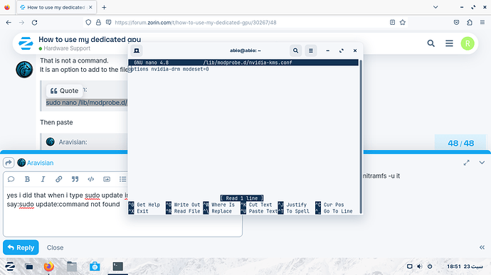

Nvidia has dropped support for drivers for this product. In using a newer kernel, I can see how this can cause problems. The 390 driver lost all support by the end of 2022.
I think earlier I recommended you roll back to the 5.8 kernel.
Can you check
sudo nano /lib/modprobe.d/nvidia-kms.conf
You should see
options nvidia-drm modeset=1
Change the value to 0
options nvidia-drm modeset=0
Tap ctrl+o
to overwrite. Tap enter
to save current configuration. Tap ctrl+x
to exit the editor.
Now update the modules to match
sudo update initramfs -u

Paste this in
Then
That is not a command.
It is an option to add to the file.
Then paste
into that file.
Once that is done; save by;
That will revert the terminal back to normal. It is then that you run:

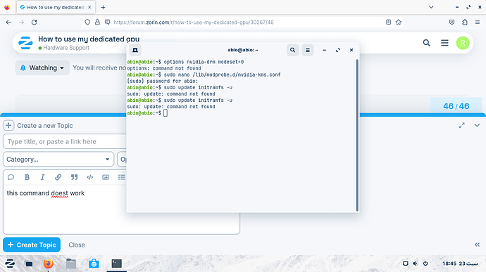

yes i did that when i type sudo update initramfs -u it
say:sudo update:command not found
i already pasted this command
oh u said it is an option but what do i do with it?
Ah, ok. I misunderstood. Previous screenshot made it look like you pasted that in terminal as a command.
You ran
and it said update: command not found
Wow, I have never seen that happen before. I am going to need to try looking this up.
EDIT:
Nevermind - I see I have a typo:
It should be
sudo update-initramfs -u
