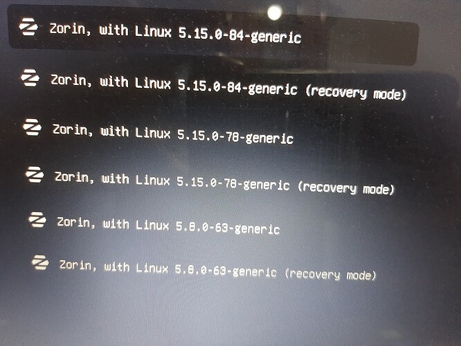

Wait boot as if I'm booting to zorin os but choose the second option?
Uhh which version should I use?
I just boot the system then chose the second option
I do not understand this question. Please remember that there are variations in computer manufacturing settings and I cannot see your screen and I have no history of ever booting your computer.
Arrow key down to Zorin, with Linux 5.8.0-63-generic
NOT Recovery mode

This will require a Reboot - so you will need to repeat the steps above - Boot to Grub Menu, then
NOT Recovery mode
