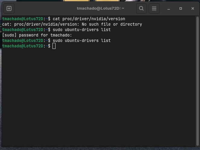

Prints below about the system, Kernel used and Software & Updates Window with no trace of possible nVidia driver options.

So, I have to do it manually. I went to Terminal to see the drivers list, but none was detected.
I've already downloaded the 390 nVidia driver. How to install it on terminal, then?
