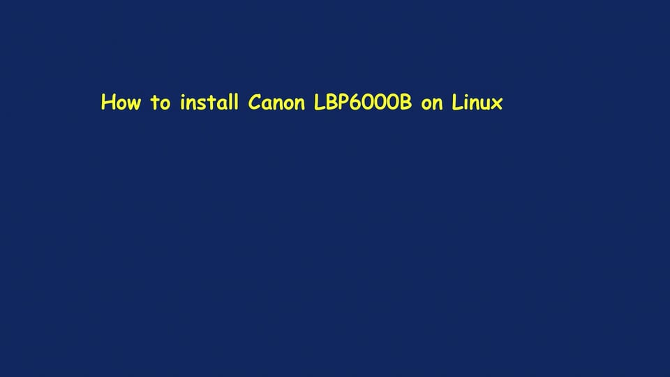

Like you suggested :
https://forum.zorin.com/uploads/default/original/3X/2/e/2ec61586e4f13898d5575edec9fb39d412c7c6d3.png
This was for a different printer but the process is the same. (Don't think I knew about printer-driver-all until a helpful person who inputs regularly to PCLOS Debian and Q4OS forum).
Screenshots are given in the Unofficial Manual for each stage of the process.
